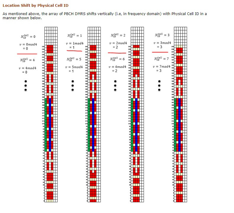

Does NR has mod4 concept?
Yes, mod 4 concept is for DMRS of PBCH.
So remainder 0, 1, 2 and 3.
Impact depends on how two conflict cell overlapping on each other.
Lesser the overlapping, lesser the impact.
But in general, Actix and TEMS tool, their SINR are based on SSB.

In LTE, PCI mod 3 conflict may affect CRS SINR quality and LTE-UE use CRS for demodulation.
But NR, PCI mod 4 affect PBCH DMRS, NR-UE use user-specific DMRS for demodulation, not cell-specific RS.
So, I dont think PCI mod 3 or mod 4 conflict in 5G-NR has big impact on throughput as 4G-LTE.
