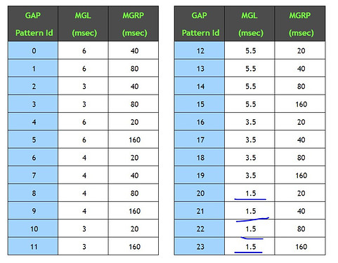

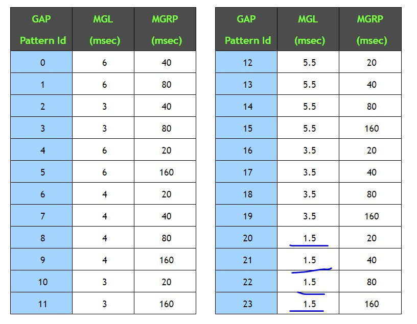

For example, in specs it was written that MGL of 1.5/3/5 and 5.5 are for FR2.
So lets say one operator deployed a SA 5G with two carrier in FR2 and UE was trying to measure other FR2 Freq and network configure it with MGL of 1.5 ms.
So how UE will read the 64 SSBs in other carrier of FR2 as it is just too low?
Where do you find 1.5? Please tell gap pattern id you are referring.
Please see below pic:

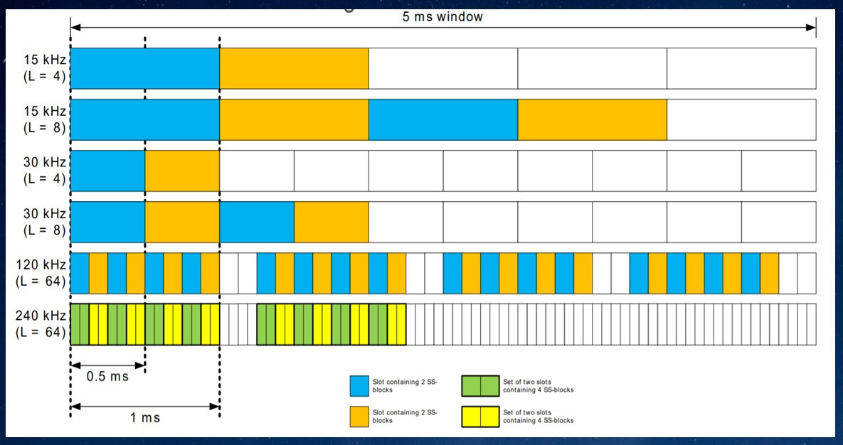

So it will cover almost 4 slots in FR2 with 120 KHz, right?
That’s where I have doubt.
So if we try to correlate MGL with SSB timing (SMTC window) in below pic, it doesn’t seems possible.
It’s MGTA that need to set true.
From from this pic, for 120 KHz, it’s is covering 16 ss blocks in 1 ms, right?
