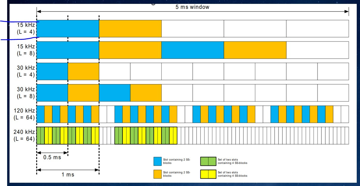

I think spec says UE must decode all SSBs in 5 ms (complete burt set) which, is half frame.
And this sweep is repeated each SSB periodicity (typically 20 ms).

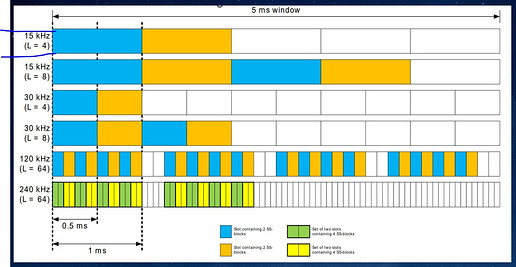

Yeah, 5ms is the complete burst set period however for an example UE can read all SSB (L=4) for 15 KHz in just 2 ms of this 5 ms as per given pic below with starting SSB symbol of 2, 8, 16 and 22.
I think 5 ms SSB periodicity was kept in order to cover all SSB in 4-5 in case of 120 kHz sub carrier spacing.
I was more referring to this comment.
I don’t see UE decoding all 64 SSBs within 1 ms.
Yes, that’s what I saw, but question here is if UE not able to decode all 64 SSB within 1 ms, then how MGL of 1.5 will be useful?
Exactly, SSB burst are sent within 5 msec, not 1 msec.
