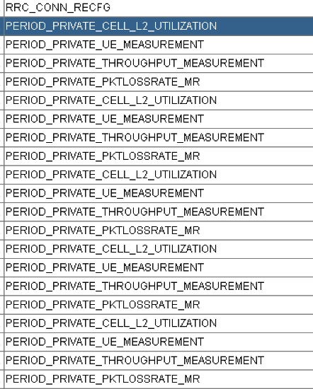

@cheikh789 M trying to locate the other procedure it is interacting with before the s1 ap message saying interaction with other procedure but i cant see any handover only rrc reconfig. see messages before failure message. could it be its conflicting with the re config

increased uu timer no improvement. it still says procedure interaction in s1ap context failure message. but each time i get that failure just like in image above, i dont see and response message from UE for Security CMD and RRC RECONFIG.
and rrc reconfig message contains srb not handover command
how about coverage RSRP during S1ap contex failure and what is value L.SecurMode.Fail

its zero,
issue is on network scale ,not particular cell.
When random trace is done on USN it picks up on diffrent enode bs diffrent subscriber.
and RSRP during trace ?
