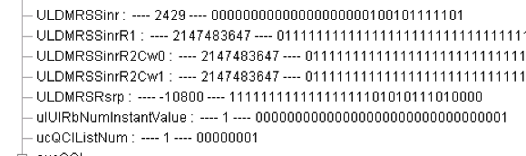

rsrp is -108 but sinr is good.

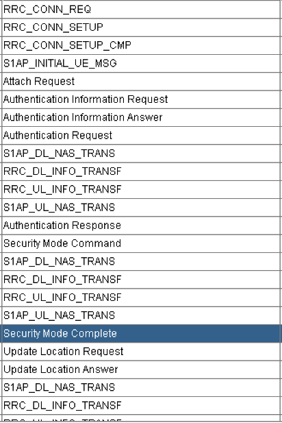

Possible reason why eNodeB not receive Sec Mod complete message from UE is due poor RF Condition of UE (Look into other failure)

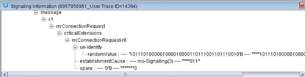

Can you check if eNodeB receive RRC reestab message from UE After RRC Secur Mod-Comand
It receives an rrc con request with establishment cause mo signalling not rrc re-establishment.then starts the process again and fails with same reason

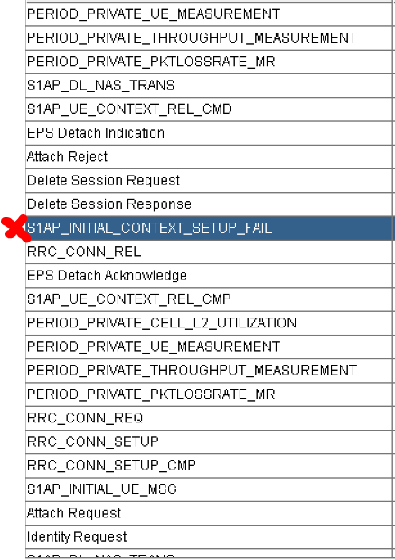

can you check Attach Reject reason ?
there is reject message on the NAS layer, such as Attach Reject and Service Reject

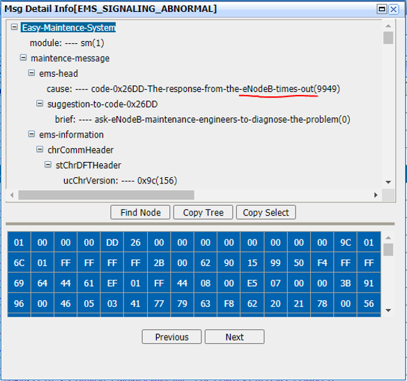

They get ems signaling message saying enode b response times out. Ask ran engineer to diagnose problem.

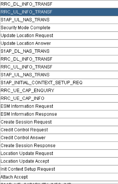

They get initial context failure saying failure in radio interface procedure.
So I check on my end and I get failure reason interaction with other procedure. But I donβt see any handover messages and no rrc reconfig &rrc security mode command completion messages.
but you click to reject message and see result
Yes. They clicked and showed me.
Ems signaling said cause protocol error then under detail it said enode b response times out.
And on context failure it gave cause 26 failure in radio interface procedure.

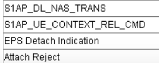

check Attach reject happen before S1AP _intitial_Contex_Fail for all 26 failure?
if yes then we can check reason
Attached Reject due to protocol error is devided into two reason
- Protocol error, unspecified (HSS Not Responding)
- Protocol error, unspecified (Security Algorithm Negotiation Failure)

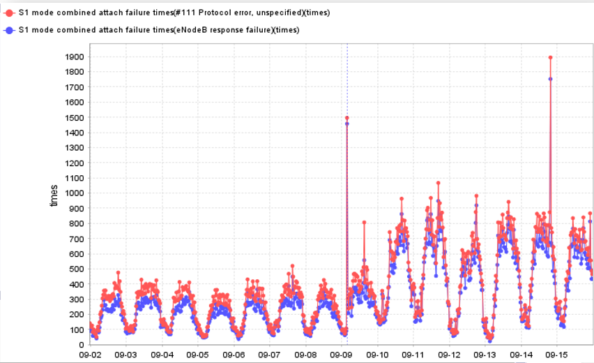

enode b response time is the biggest contributor. the rise shown on the 9th was due to increase in context failures due to no radio resource,but that was rectified and it is now back to the 400 times.
when i run context fail counter in u2020 it has a high number that fall under unknown.
