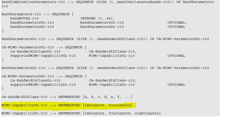

Please tell which IE there.
For DL it is this one:
But for UL not sure.

Yes, DL is fine.
Question now how to check UL part…

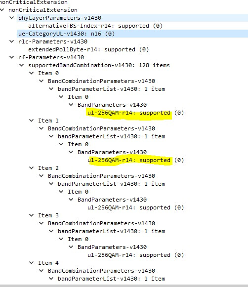

For Uplink, modulation can be 64 QAM and at release 14, 256 QAM, and 2CA for Uplink.
I assume it will be in same picture above if UE supports it!
Yes, correct.
Yes it will be same only and it will be shown explicitly as highlighted.

256 QAM in UL:

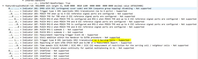

Uplink CA:

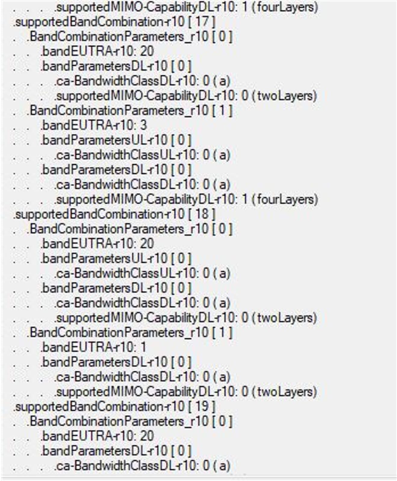

Uplink CA is different.
You can check from CA bandwidth class UL.
