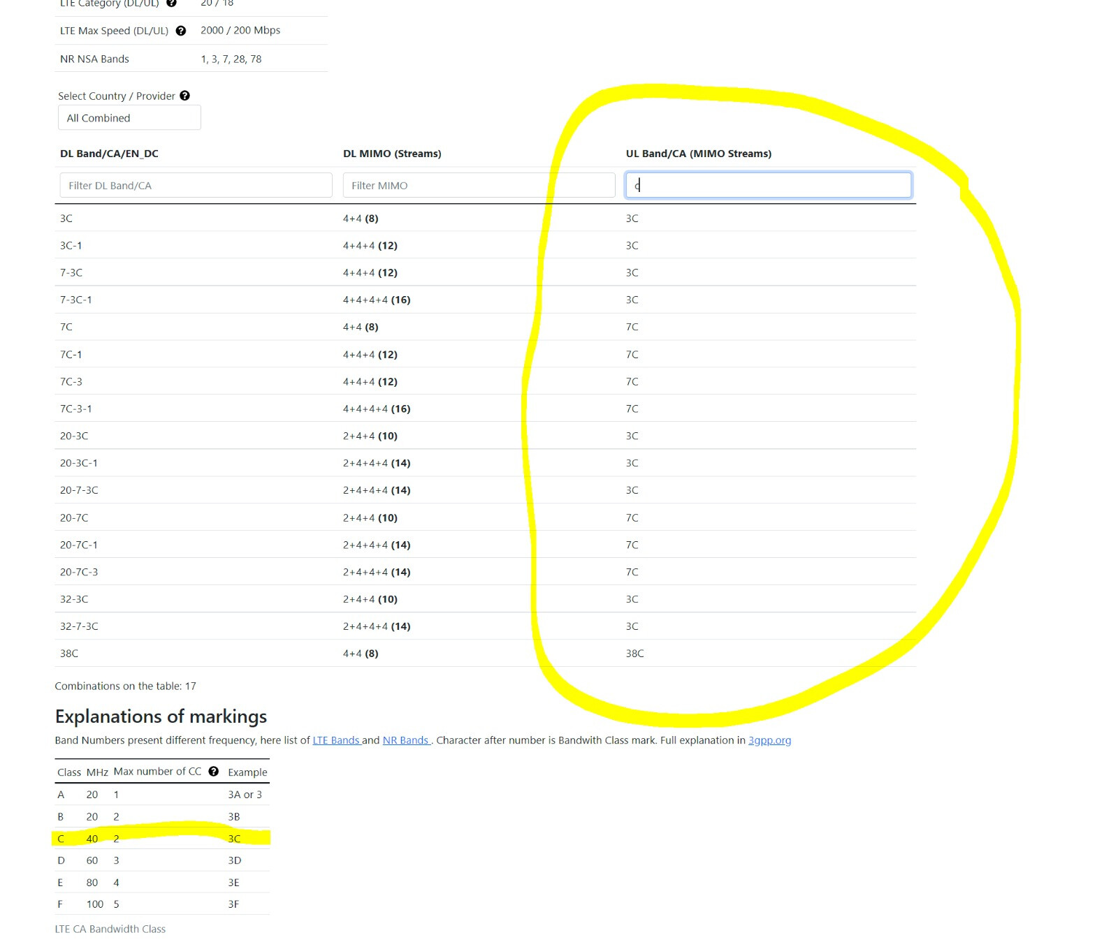

Max BW class seen as C i.e. 2 CC CA in Uplink.
CLASS C would actually mean intraband!
Class C indicates 2 CC here.

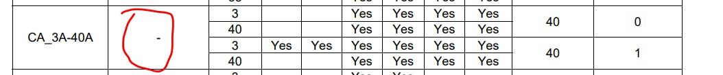

So in Uplink CA combo like CA_40A_3A not possible?
Class C means intra band contiguous component carriers.

Please confirm inter band UL CA possible or not.
It is given in specification.
I think it’s allowed but based on band combo.
Ok, I think same. Thanks.
3A + 40A UL CA is not supported as per specs.
40a-3a possible only in DL, in uplink we have 40C (20+20) and 5a-3a (10+10) in our network.

But you asked specific band combination, that is not supporting UL CA.
