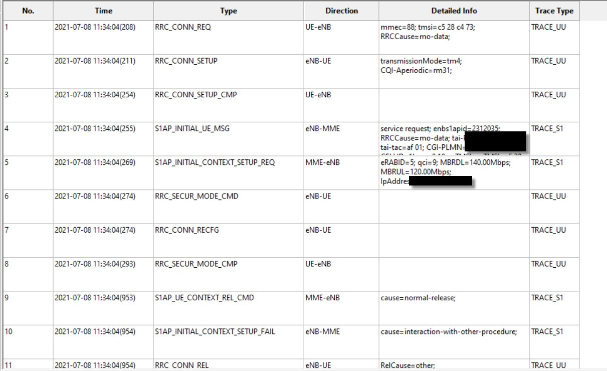

In my NW, very high pegging of L.E-RAB.FailEst.MME is seen on almost all sites. But it’s not related to MME. I have analyzed traces and release cause is normal mostly on Uu Interface. At S1 Interface, it corelates with S1AP INITIAL CONTEXT FAIL due to interaction with other procedure (MTC Call). Is there some feature/configuration to avoid pegging of L.E-RAB.FailEst.MME or pegging it as normal release at Radio Interface as E-RAB SR as 99.86% at NW is not achievable after stuggling with all other possible configurations.

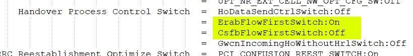

Enable parameter csfbflowfirstswitch under globalprocswitch.

What is the setting of the other switch .
It has a csfbflowfirstswitch and an erabflowfirst switch.
You might need to switch off the erab first.
Look at my net params:

Opening CSFBFlowFirst Switch will improve CSFB failures due to conflict with HO procedure in prep phase.
Yes already tried this, if I set this to e-RAB then it only improves RNL failures, no change in MME failures.

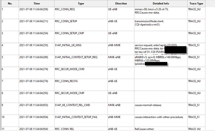

in this image of the trace there is no handover procedure shown but cause is still showing interaction with other procedure.
Did you ever find out what procedure it was referring to?
