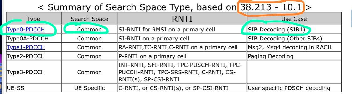

Common type 0: used for SIB1 (SI-RNTI)
Common type 0A: used for other SIBs (SI-RNTI).
Common type 1: used for Random access - RACH (RA-RNTI, TC-RNTI)
Common type 2: used for Paging (P-RNTI)
Common type 3: used for Gropu signaling (power control, SFI, etc)
UE-specific: UE specific signaling

Remember that for the selection procedure, the UE must get the MIB, then it will decode the PDCCH using the SI-RNTI with the Type 0 Common Search Space (CSS).
This will provide the SIB1 which is your INDEX for the remaining SIBs.
From SIB1 the UE will extract the pagingSearchSpace and then with the Type 2 CSS the PDCCH decoded using the P-RNTI which allows recepttion of PDSCH resource allocations for Paging Messages.

One CORESET can be associated with multiple Search Spaces, but every Search Space is unique.
As per 3gpp, search space 0 can be only used for SIB1, but CORESET0 can be used for other CSP also.

As I understand, the pagingSearchSpace IE can have all values {0,…, 39} (see 38.331 in PDCCH-ConfigCommon IE).
But her you’re saying that searchspace id 0 can’t be used for paging and its only for sib1?
Are you sure these values are css types?
Yes, it’s located in 38.331.
Sorry, your understanding is not correct.
Check again about the IE’s exact values and its interpretation correctly.
For any further doubts share the print/snap of the text you’re reading for better understanding.
