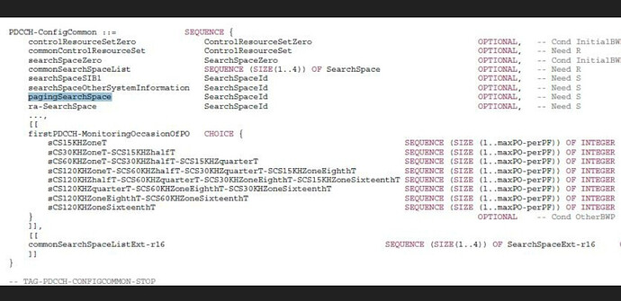

The pagingSearchSpace IE can have all values {0,…, 39} (see 38.331 in PDCCH-ConfigCommon IE).
In case it has the index 0, one should simply follow the CSS configuration as given in table 10.1-1 in 38.213.
Maybe I am wrong?

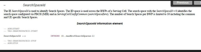

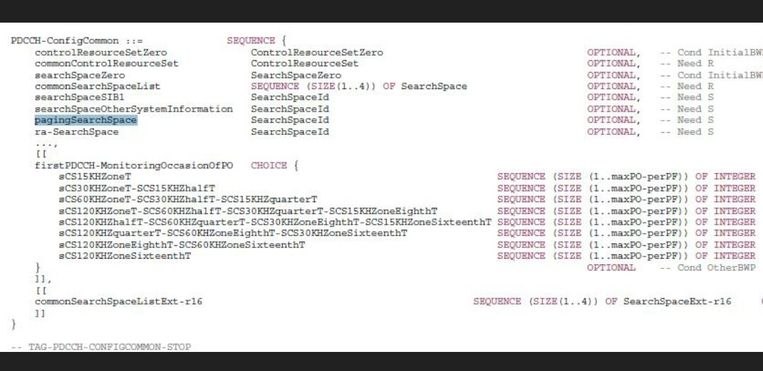

These snap dosn’t convey the info you’re telling.
The conveyed info is “pagingSearchSpace will have the value of searchSpaceID and searchSpaceID can be 0 to Max-1”.
How do I co-relate?

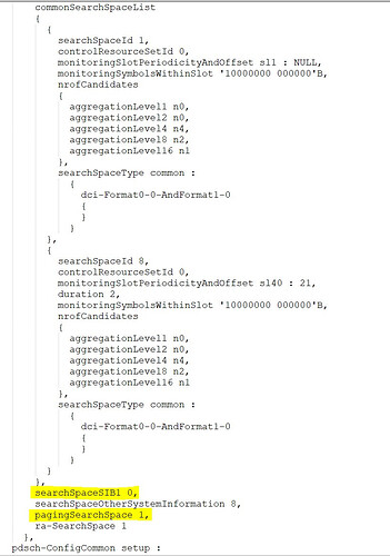

The question was: could we use searchspaceID 0 for pagingSearchspace?
It seems yes according to my snapshot above.
So, searchspaceid 0 isn’t unqiue for sib1 only. We can use it for paging searchspace also… ?

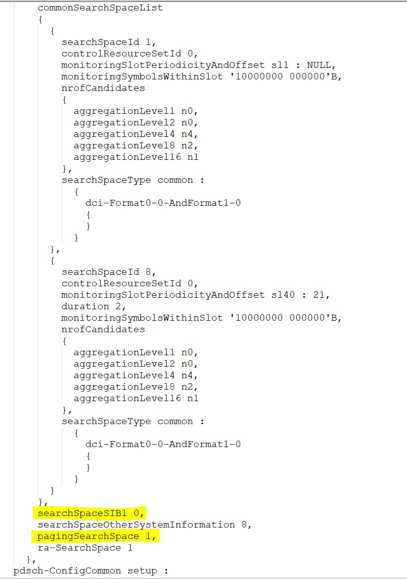

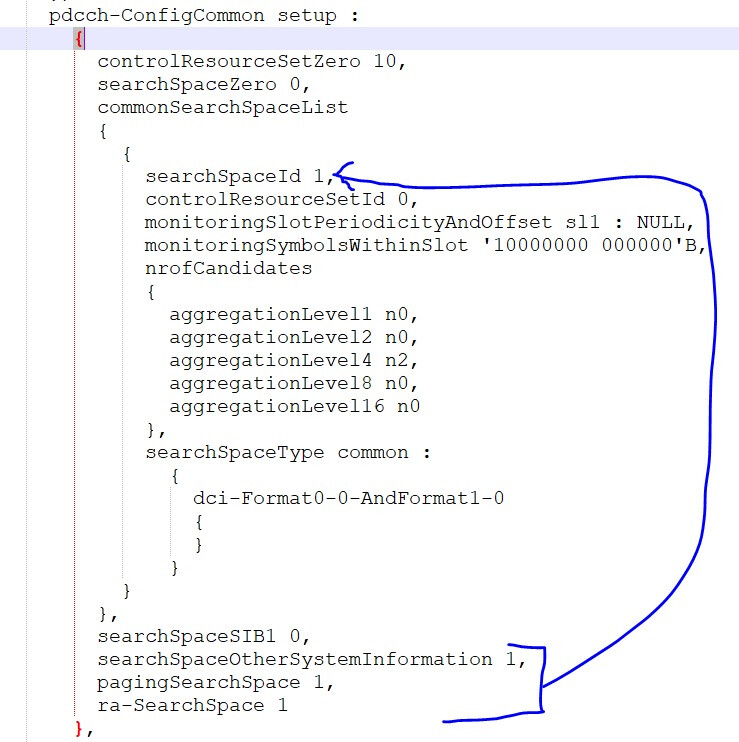

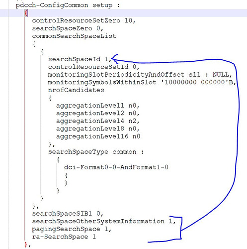

See in this log. searchSpaceID 1 is mapped to searchSpaceOtherSystemInformation , pagingSearchSpace, ra-SearchSpace. All three have different search space type… Type0A-PDCCH for other SIB, Type2-PDCCH for paging and Type1-PDCCH for ra

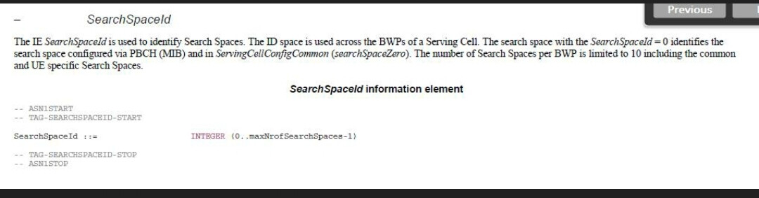

As mentioned here above, searchspace id 0 can be only used for sib1. So this is not right, and can be also used for paging…
I also see that searchspaceid1 is for SIB1 while searchspaceid1 was used for paging.
My question still remains: can we use searchspaceid 0 for paging and not only to be used for sib1?
In the image you showed that searchspaceid 1 is used for paging.
And searchspaceid 0 in your image photo I see its for sib1 as well.

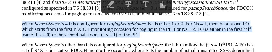

Hi all…

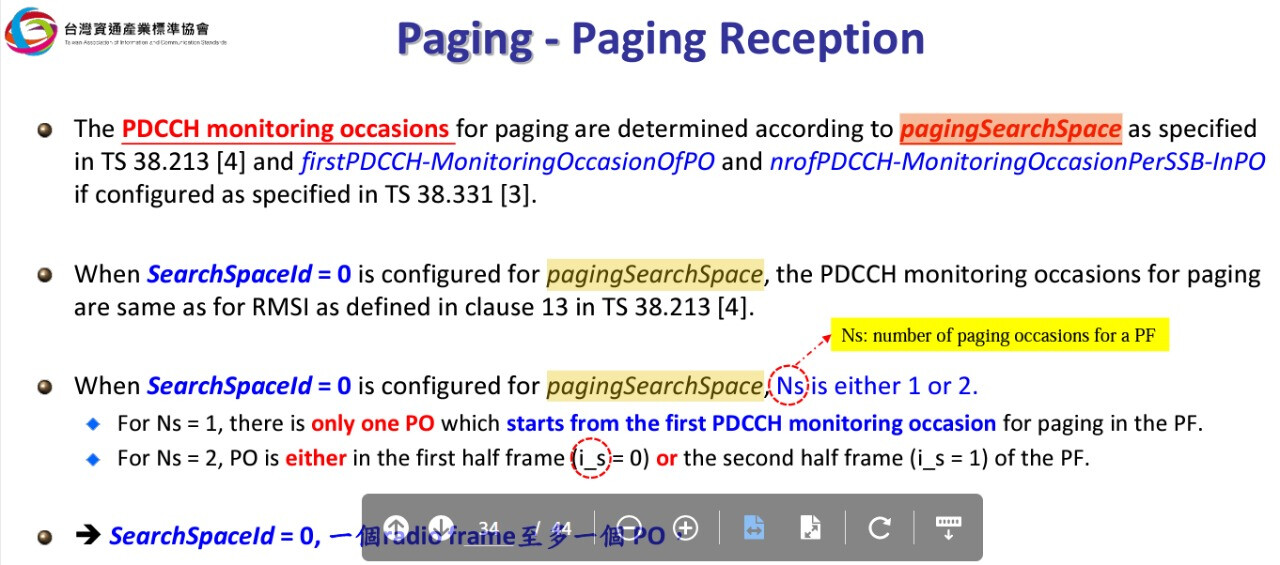

I have found the mention of pagingSearchSpace=0 in 3gpp.
Source: https://std-share.itri.org.tw/Content/Files/Event/Files/2.%20NR%20idle%20mode%20status%20Overview_JM_V0.pdf
Source: https://www.etsi.org/deliver/etsi_ts/138300_138399/138304/16.01.00_60/ts_138304v160100p.pdf
