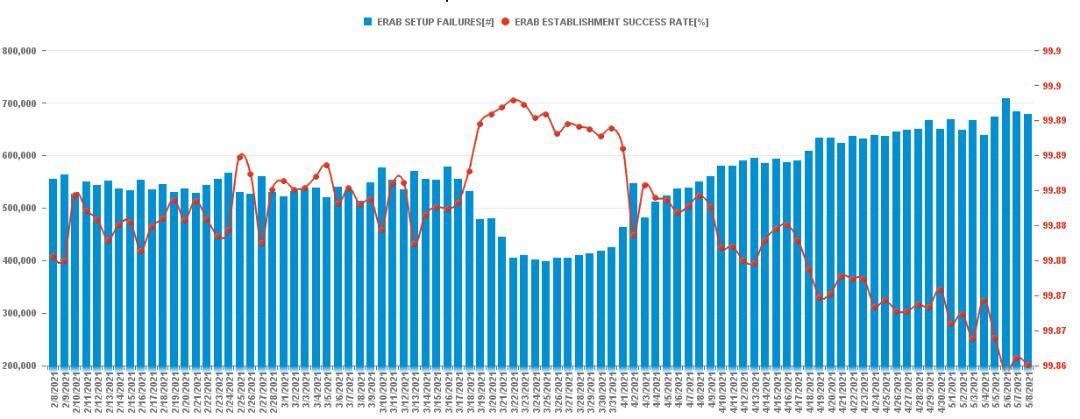

Here is an interesting case of gradual degradation in Erab Setup Success Rate.
Traffic is/has increasing but is not matching with this declining trend.
There are no particular worst performing cases which are the reason for this.
Question is: if it is radio conditions, how it is degrading without any actions in the network?
The decline is on all the layers we have.
Any clue here?

VoLTE is also there, question is how radio conditions deteriorated which any major actions in the network.

I checked the Core traces and cause Core traces said “The-response-from-the-eNodeB-times-out(9949)”.
They are matching the traffic increase with no license issues on RAN part we have enough.
It might be due the UE at low coverage or low RF quality he is not recieving the acknowledgement within the enodb timer.
Please trace the busiest hour.
What was the sinr, rsrq, rsrp?
This is my suspicion too.
These are from MME trace, not from eNodeB. Will check the CTR too.
You have the trace, check the RF.
Oh, ok.
