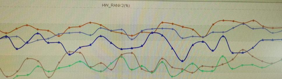

Any suggestion to about how to improve Rank2 MIMO ratio?
Huawei system.
In some sites there are > 95% Rank1 samples.
UL RSSI is > 120 dBm.
Max TA ~500 m.

One of them have ~2% rank2, another ~25%.

Haven’t done DT yet … checking using statistics (% of rank1/2/3/4 samples).

I am having this same issue, but for one cell.’
What could be the reason of a 99% rank1 utilization knowing that the antenna is a configured as 2x2 MIMO and radio conditions are good?
All the cells of the eNodeB.
1 cell is less than 2% as rank2 utilization:
