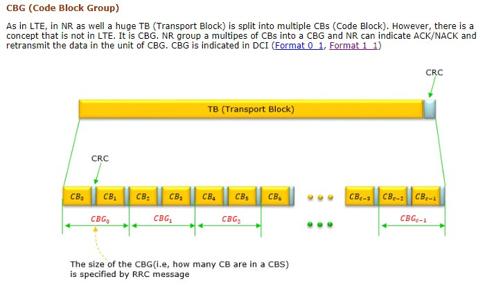

5G NR Physical Layer Procedure: Code block group (CBG) based transmission
I see that “UE will decode these code block groups (CBGs) and will send HARQ feedback (ACK/NACK) for each of the individual groups”.
ACK/NACK is at CBG level.
Splitting the TB in CBGs means it is MAC layer job?

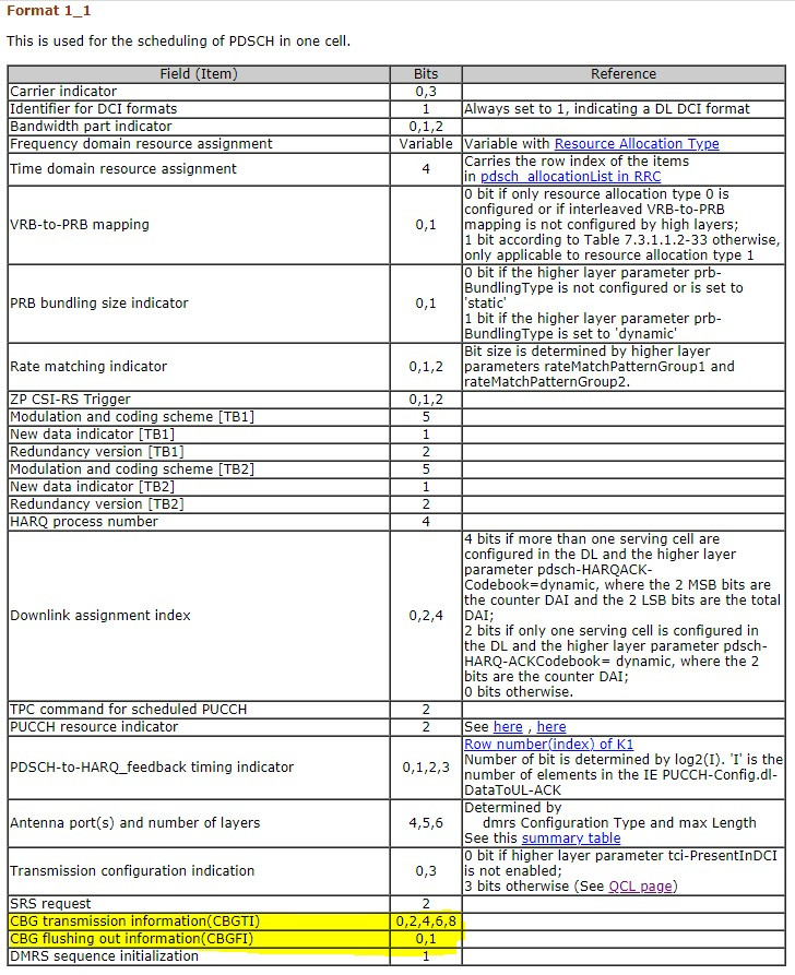

In sharetechnote it is saying that UE is informed about CBG or not in DCI: CBG is indicated in DCI (Format 0_1, Format 1_1)
Yes. Does your log have the DCI info?

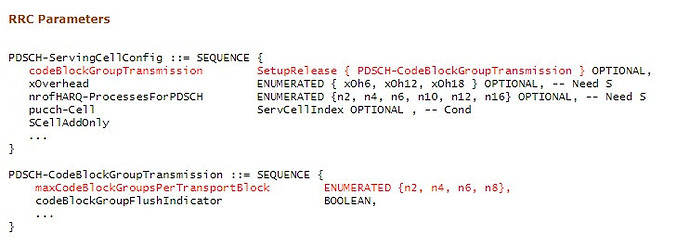

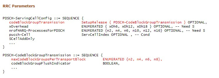

But first we need to see CBG configured at RRC level which I do nto see:
Please check in your logs, maybe you can find this RRC config for CBGs.
If that is not configured, nothing to send on DCI.
It’s not mandatory IE then.
I cannot find CBG configured in RRC, I checked few logs.
Yes, it says it is optional.

Sharetechnote says there is a CRC for each CB, for each CBG and for the entire TB:
I believe this CRC happens at phy layer for CB and CBGs and at MAC layer for entire TB.
