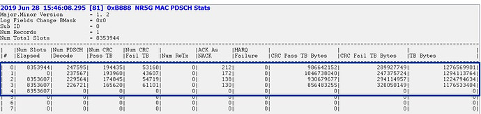

I am confused about that excel file that I shared.
There is CB information inside yet the entire TB is retransmitted.

From NR logs no info for CBG. Seems not used as of now.
