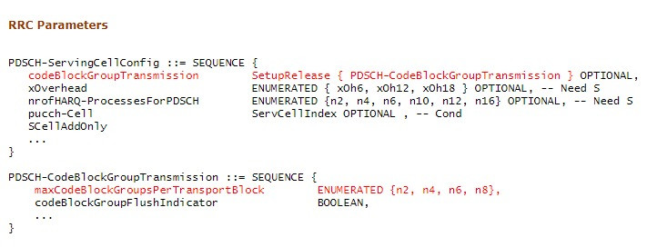

But max CBG per TB can only have value 2,4,6 and 8. How come 22?
This is what I see in logs.
21, 22 or 23 CBGs.

What is intresting that CB has values like 23 24 although one line represents one slot.
This can still be valid meaning that there are max 8 CBG but CB can be 23 or 24.
I think CBG is not configured maybe.
We nee to check RRC for that.

If CBG is configured, I donât expect the whole TB to be retransmitted.
It should look like this in the log but I could not find it:
