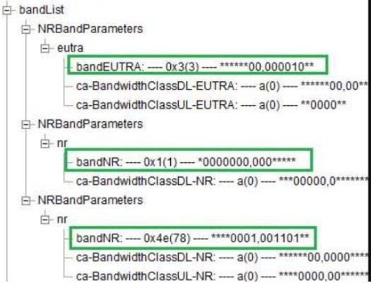

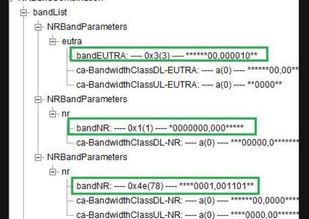

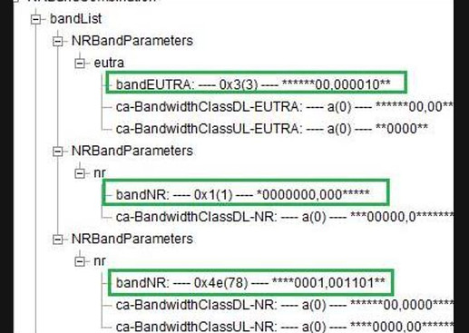

In this NR CA (N1+N78) what will be PCC and SCC?
Is it possible to know that from log?
I think you can check which band cell got added recently will be the SCC.
LTE B3 is PCell
NR n78 is PSCell
NR n1 is SCell
Thanks!
Between both NR bands, why N78 is PCC and N1 is SCC?
Because N78 has DL and UL and N1 has only DL?
I found this:
PCell Vs SCell:
  • PCell always have both Uplink (UL) and Downlink (DL).
  • SCell always have DL (While activated) but may or may not have UL.
Is it a role?
Only be aware that CA in UL not too many devices support it yet.
Yes, correct.
I think for this UE, DL CA n78+n1 anyband can be pcell.
But for UL CA, n1 not support, only n78 support, it can be n78 intra-band UL CA.
Pcell, pscell, scell, spcell this we know.
NRpcell, NR pscell, NR scell: New terminology
Friends spcell = pcell + pscell.
But still for NR you can see spcell as terminology.
Why spcellconfigcommon and spcellconfigdedicated used for NR?
As spcell= pcell + pscell
I disagree for the said band combination. n1 cannot be pscell becuse it do not have UL support.
Log do not say: n1 do not have UL.
It just say: n1 do not support UL CA
Yes, consider this as a rule.
Thanks.
