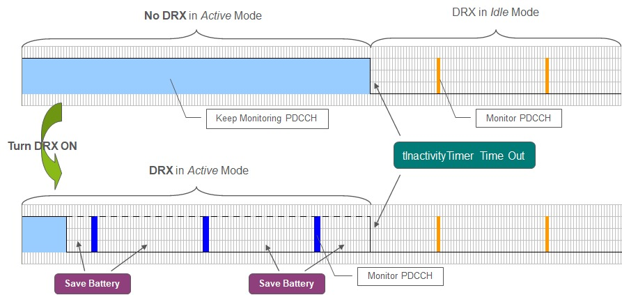

DRX used for battery saving where UE go in sleep mode and don’t read PDCCH.

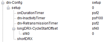

Parameter in RRC connection reconfiguration given to UE, from network.

If there is only long DRX UE will read PDCCH after fixed interval say 320msec.
If there are short Drx cycles UE can wake up before 320msec multiple times (no.of short Drx cycles) for short durations (short Drx cycle time) and read the PDCCH for messages.

Something like this:
