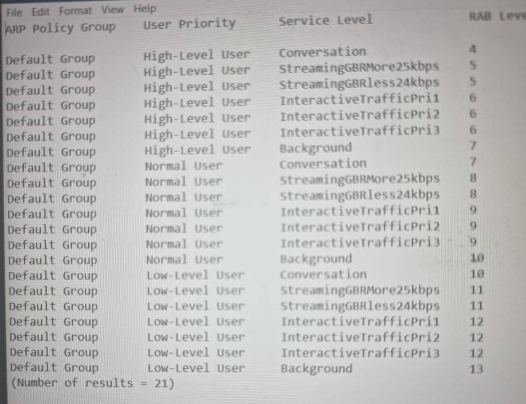

You have to do Service differentiation based on RAB and synchronize with CN about the strategy.
QOS service differentiation.
This by defining the ARP based on user priority with differents services level and RAB priorities on CN level.
And set the same at RAN side.
Example:
