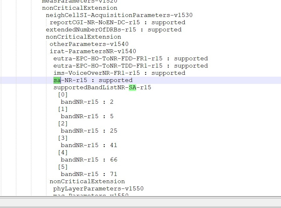

I also found in actual UE capability as below
If supportedBandListNR is there in UE capability-> UE support SA for those band
If only rf-ParametersMRDC is there, and not supportedBandListNR, the UE support NSA only between LTE and NR, SA not supported here.

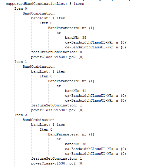

Even reporting supportedBandListNR is not enough. This is the indication of per band capability which is common to SA & NSA. UE needs to report the corresponding SA combos to indicate the support of SA to network. Network will use these combos to redirect/HO the UE to SA network.
Hi pradeep, what do you mean please by saying “SA combos”? I didn’t understand the meaning / implicitly meaning of combos here …
Appreciated if you can explain.
UE must report in UE Capability Information Message (nr) supportedBandCombinationList. This list depends how your network request it too. Example this UE support n38, n41 and n78 SA.
On https://cacombos.com website you can find different devices support different 4G and 5G combinations. If your UE missing on site would be nice if you can submit your device log to complete listing.

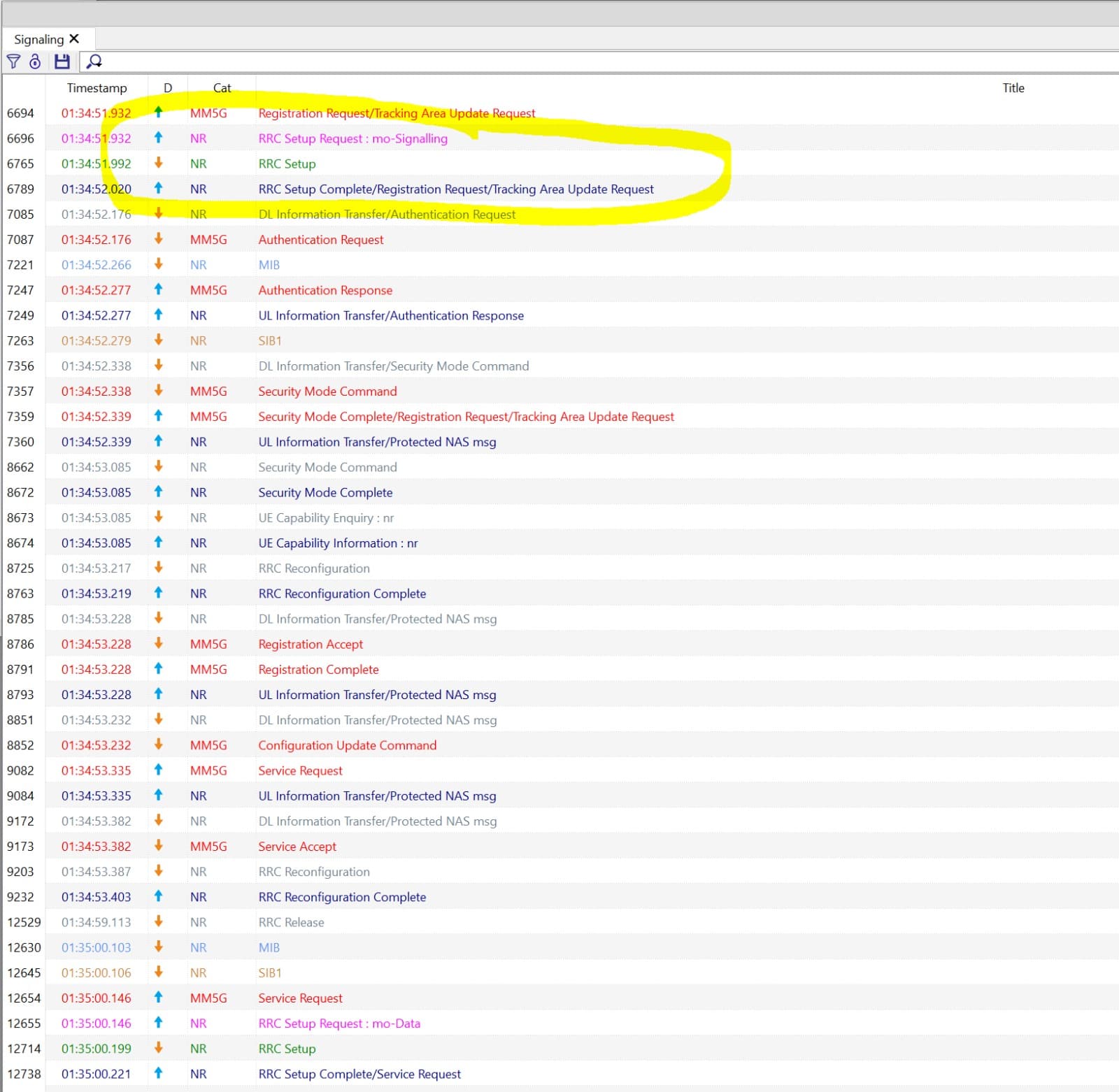

If you see RRC connection request on NR after MIB /SIB1 this is SA. ![]()
RRC Setup request.
Right! Thanks @RFSpecialist !
From sib1 content different from LTE we can also judge as it’s mostly seen in SA networks having spcell structure.
