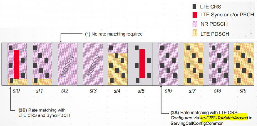

Is it “lte-CRS-ToMatchAround:setup” to be present in NR RadioBearerConfig in case of DSS=true?
I think this is it.
Yes and also mbsfn subframe configuration.
Check Sib2 & rrcConnectionReconfiguration message, you will get this.
Though it is not mandatory, most of DSS implementer would use it.
There are three different DSS use cases:
- NR is in MBSFN
- NR is in MBSFN
a. Subframes without PSS/SSS/PBCH
b. Subframes with PSS/SSS/PBCH (0 and 5)

And SCellToAddMod IE in RRCconnectionreconfiguration message before this check UE capability to verify UE supports ESS or not.
Case 2b cannot be used.
This IE is for CA.
Yes, normal.
Another IE that indicates that DSS=true is presence of “frequencyShift7p5KHz” in the NR messages.
Yes but its not mandatory for all NR bands right.
