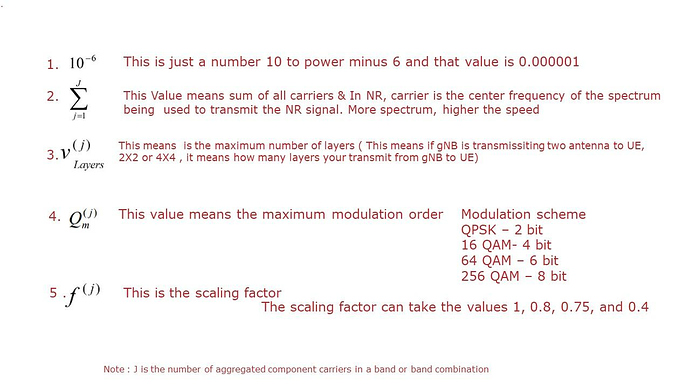

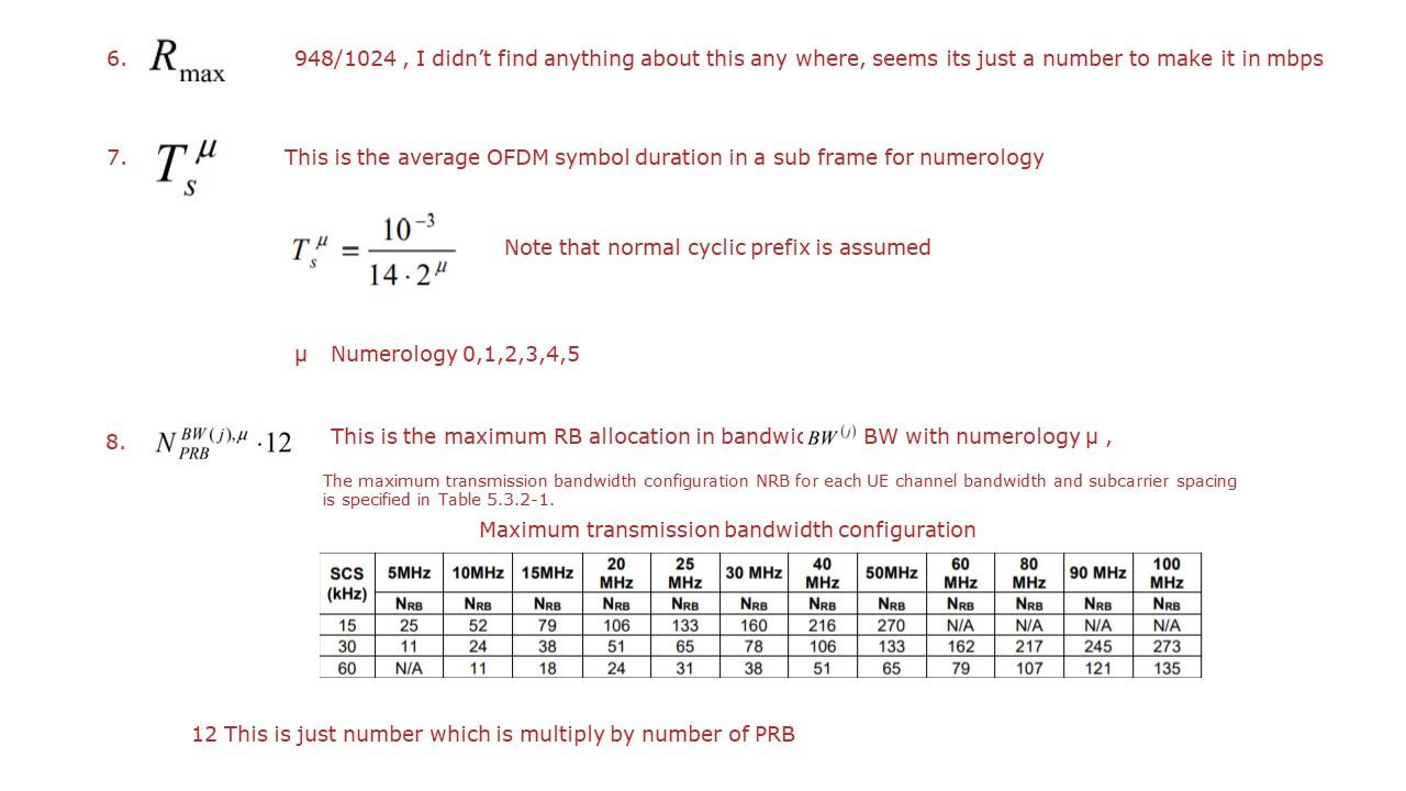

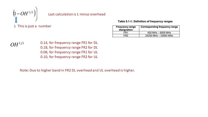

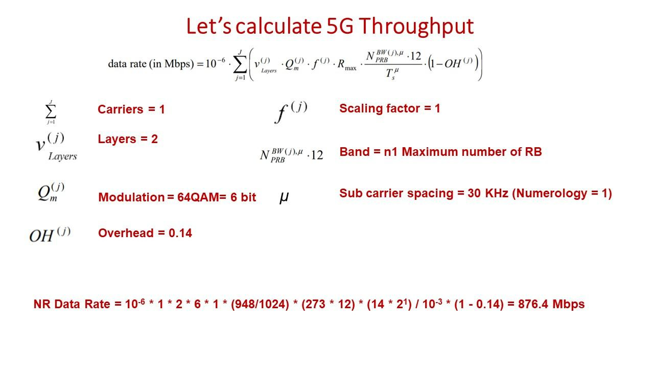

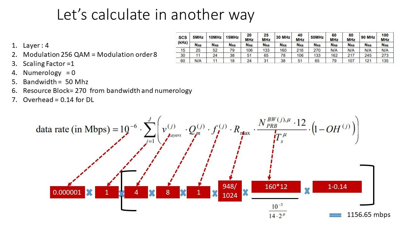

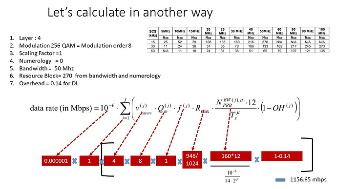

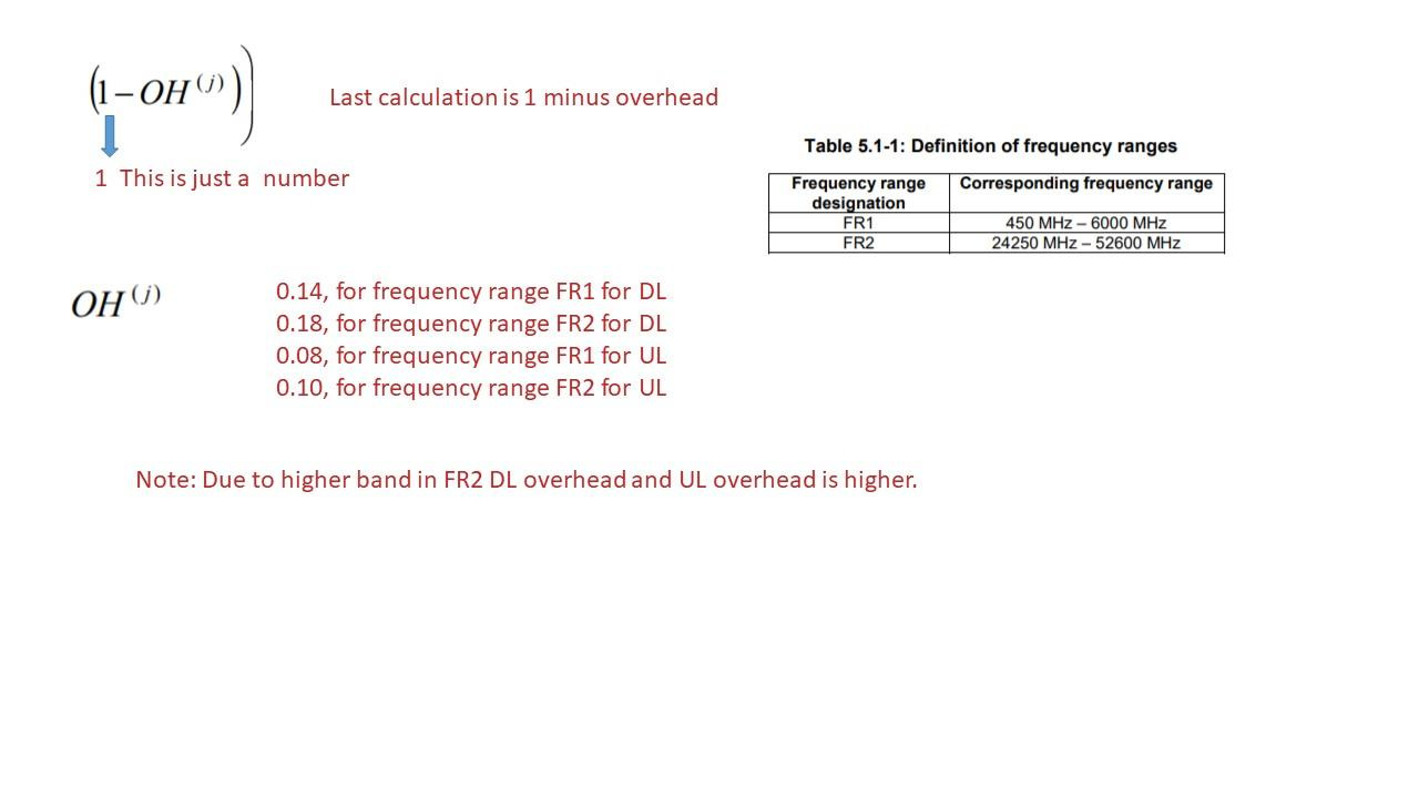

Dear Brother,
Hope this will hep you. We can Calculate 5G throughput in 2 ways.
One way is the below
1.
In other way is:-
2
Hope this will be helpful for you to understand in a simple way.
You can “Calculate Throughput as per your requirements or values for QAM, CARRIERs, LAYERs and Numerology(based on BW, RBs specified in the table)”.
