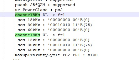

I have only this per band regarding supported BW:
This is what I meant by channel-BWs-v1530.
Facts you have this means, phone is SA capable.

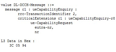

Check whether UE reported UE capability for NR only.
But this is what network asks.
I just have NSA logs of that UE.
If UE have reported UE capability for Eutra-nr then UE is not supporting SA.
UE reports what network asks.
I have an nsa log of that UE.
Of course network will not ask NR only capabilities in that log.

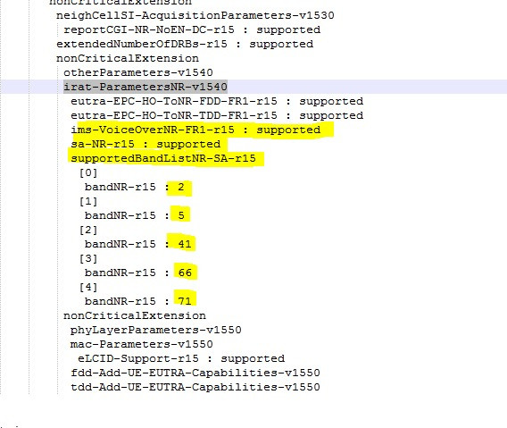

You can check UE capability info for eutra there you can see NR SA bands.
You can check 36.331 for particular IE related to NR SA.
But @RFSpecialist, even eNB is only EN_DC capable, I saw that eNb still asking NR capability.
If supportedBandListNR is there in UE capability-> UE support SA for those band.
If only rf-ParametersMRDC is there, and not supportedBandListNR, the UE support NSA only between LTE and NR, SA not supported here.
UE capability enquiry it may ask to UE ie NR config.

It definitely supports SA:
