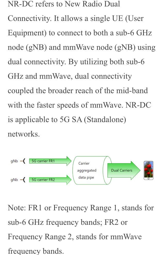

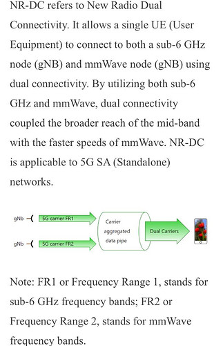

This would be NEDC.
Sorry I thought you meant MRDC.
Yes correct.
I haven’t seen the NRDC cap msg, but differentiation based as FR1 and FR2 bands can’t be done? FR1 being the primary.
Sorry, didn’t get your point.
What you mean differentiation?
I mean you must be utilising sub6 with mmWave.
So you can segregate sub6 and mmwave in combinations list, right?
That should give the info about bands which will be connected in dual mode.
In combination list it will tell me about CA, whether FR1+FR1 or FR1 +FR2.
How do I make out which out of the band combos is the also supported for NRDC?
Even FR1 + FR1 is possible.
But in any case, even if we go for FR1 +FR2, that would be listed as CA band combination in Band combination list IE.
How do we make sure we are can use it for NRDC?
