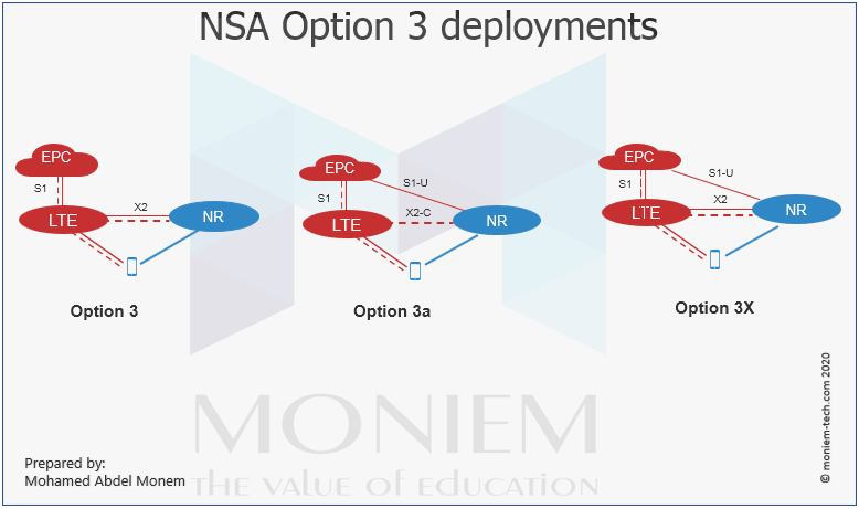

Please check this for NSA option 3X end to end scenario:
Before adding the 5G as SgNB, you have to measure And report B1.
