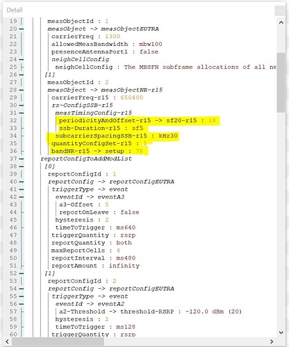

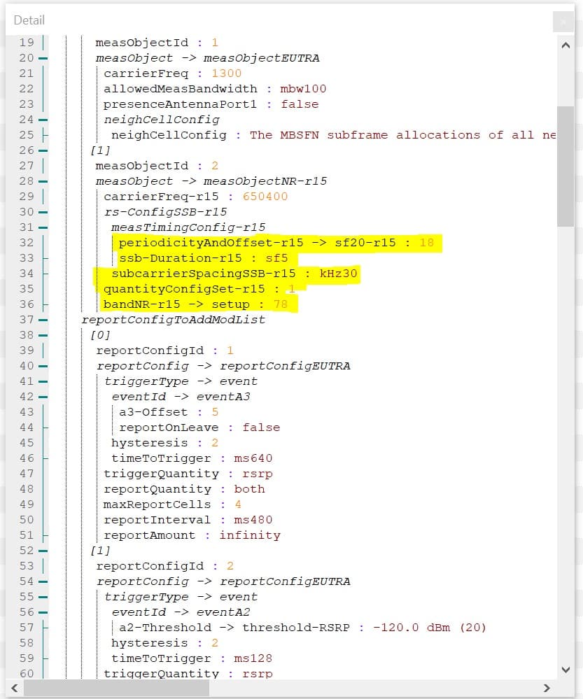

  • I have verified initial ENDC message exchanges including UE support/NW support (UE capab. exchanges). Also I verified the RRC reconfig for NR measurement object with SSB, periodicity/offset along with SCS spacing details also shared with UE.

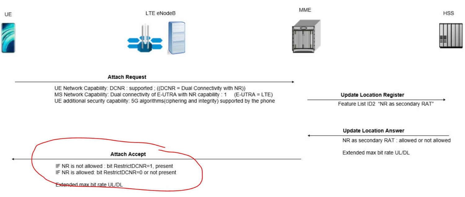

  • Step1: did you exclude the SIM issue not provisioned for NR? Check in attach accept restrictedDCNR=1

  • Step4: Check settings in yellow:
Verified this, Also as cross verification. Commercial REF phone is working with same sim and location. I do not have commercial ref logs
I will try to check Steps 2, 3 and 4 as mentioned.

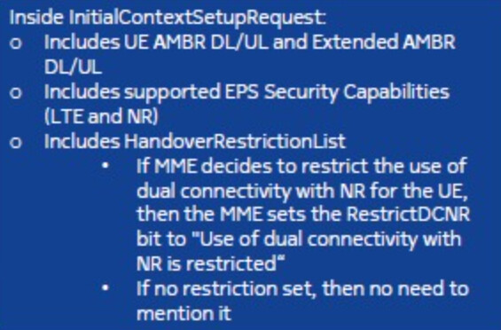

There is 1 IE like handover restriction i think in attach accept.
If it’s value 1 then it will impact SCG addition.
Thank you. I will try to verify this too.

Do you mean here that on attach accept on LTE there will be parameter restricedDCNR=0 then it can have NR?
SSB issue could be UE only support specific band and where SSB center freq were on different freq band?
Where this message found on SIB2 LTE RACH?
Do you mean restricted DCNR param?
