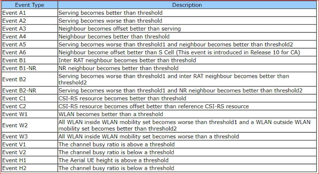

EVENT_A2: Serving Cell becomes worse than absolute threshold.(Poor Radio condition)

In any telecom technology ( 2G, 3G, 4G or 5G ), mobility (handover) decision whether mobile device will be handover or not is taken by by base station based on measurement reports from the mobile device. There are multiple measurement items ( RSRP, RSRQ, SINR ) and multiple ways ( periodic , event triggered ) to measure the signal quality of the serving cell and neighbor cells.
Here you can find more details about these measurements events:
Carrier agg A2 and A4 RSRP is for PCC and A6 both SCC that why in CA A2 value RSRP is kept less than A4.
