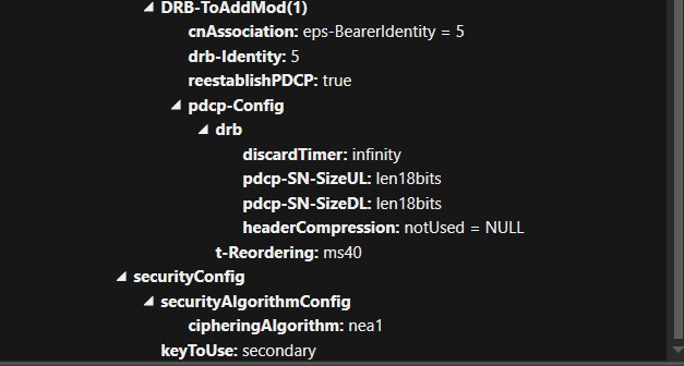

First we establish a berear as per below config (this is ENDC case)

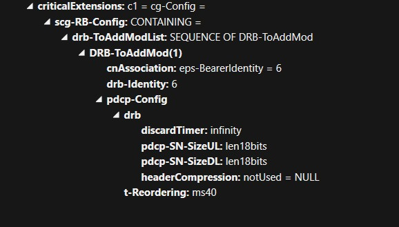

Then we establish another bearer (DRB 6 and EPS ID-6) as below
or it is mandatory to configure security configuration during DRB setup
during DRB 6 setup, security config is missing…so here UE will use same security config as configured for DRB5 earlier.

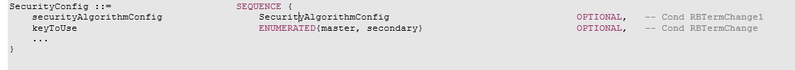

But the specs should say exactly what happens when this optional IE is not used.

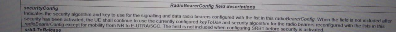

Not able decode 38.331 properly, as there is some confusion in a statement.
But for me more it looks like it is mandatory to configure during DRB setup.

What statement?
Isn’t the IE itself optional?

Reading this it must be present whenever you are setting up a new DRB.
But now if during the setup of DRB6, if I change the security config then it will apply on both DRB 5& 6.

Yes UE will use DRB 5 security config.
