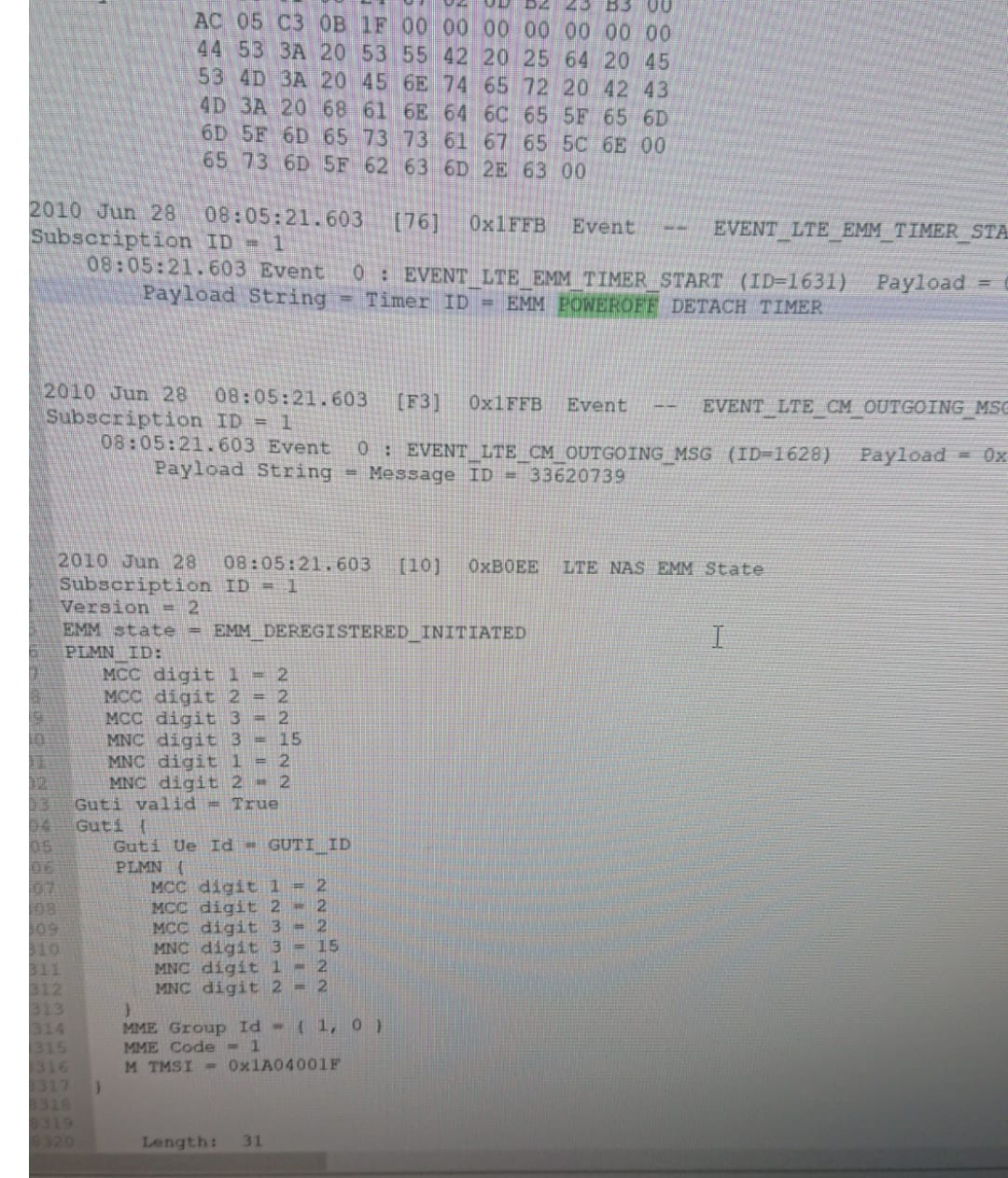

Hi Experts,
Someone knows the reason for this timer before detach cause:switch off?

From screenshot you sent, my guess is T3421.
But if you can explain which interface is this then may be able to check further.
Looks like Qualcomm QXDM logs with NAS decoding.
In Wireshark?
Looks like a Wireshark trace.
I thought QXDM logs can only be decoded with Qualcomm own SW (QCAT?)
Yes, from QCAT is the log.
Can you make a larger picture?
Not entire message is seen.
Yes, UE establish default bearer and after some time I see that msg with poweroff and after that emm_deregistered_initiated.

But looks like no pdu on the rb config index 2 - - > drb.
I see only on srb pdus.
