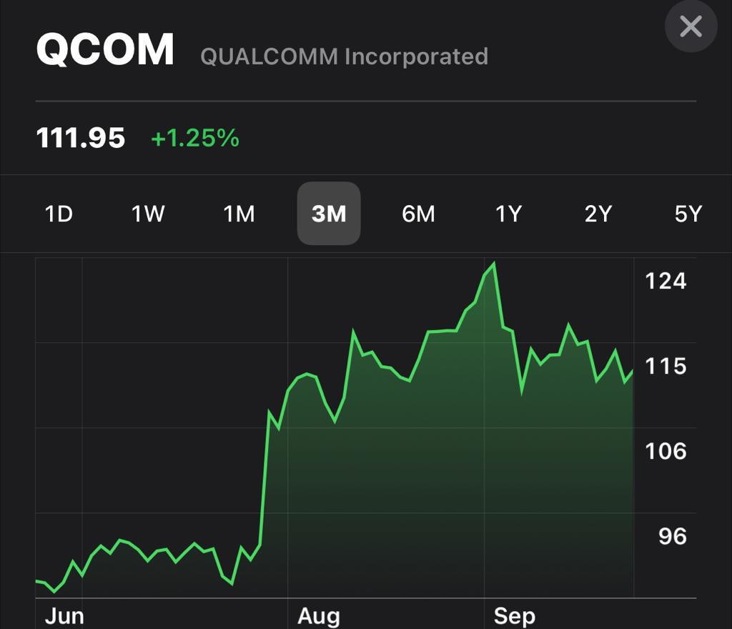

Well, Qualcomm have good royalties no matter what due to their early patents in any technology.

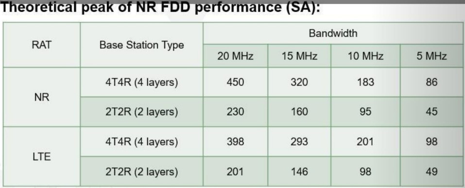

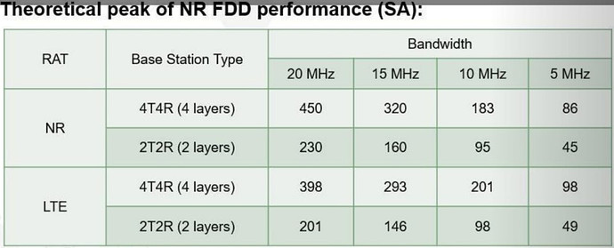

Just look at following table and you will understand that throughput gain in 5G compared to 4G is not so much.
Yet, not technically worth it yet!

Having that table in mind, even DSS for me is a bit of non-sense.
If PRBs are not used in 4G will not be used in 5G either.

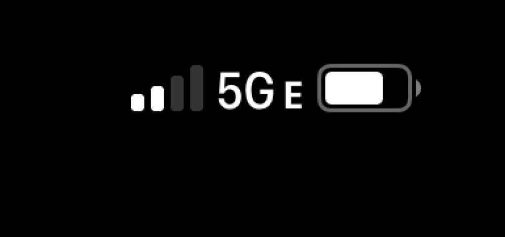

So DSS is more about the 5G icon on screen than a real usage of it.
Key technical gain is to extended UL on scenarios with higher NR carriers, like 3.5 and mmWave.

But end user doesn’t know this, he just see 5G icon on screen and expects high throughput.
And that throughput doesn’t come easy as he expects.
