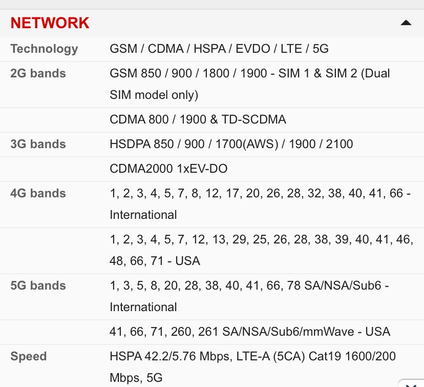

You can check sites like gsmarena.com to see for any handset.
Every operator PLMN (SIM) can be mapped with the support band and ARFCN (defined on device/modem) level.
You can find something like this in gsmarena for any handset.

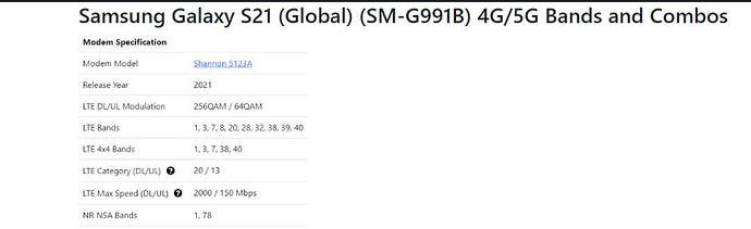

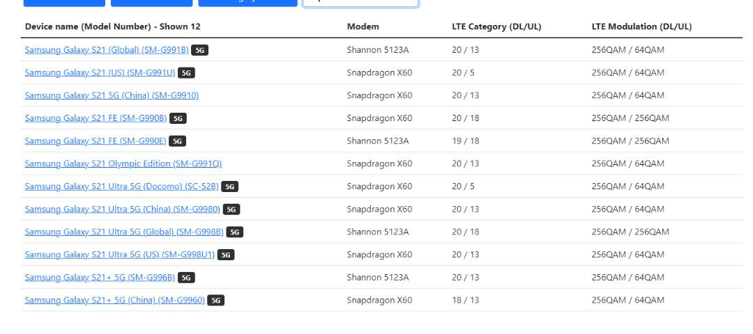

Confusion is coming from CACOMBOS also, there are 12 S21 models, if you check 991B, there is no SA Band mentioned.
Whereas for other models SA is mentioned
Only for G996B and G991B SA band is not mentioned

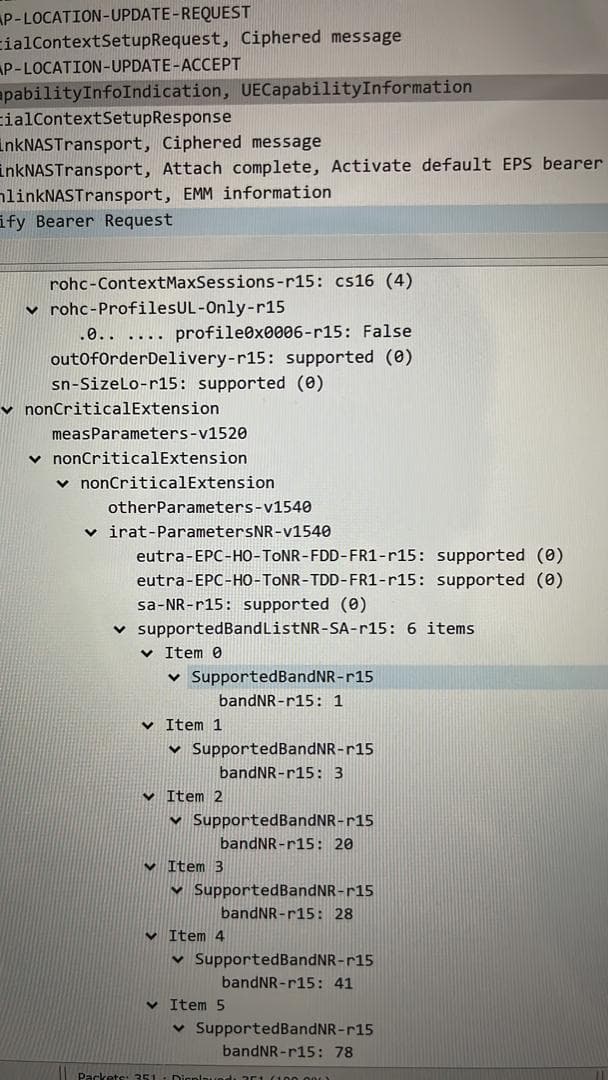

cacombos puts data based on UE capability message and UE capability is different based on firmware and regions.
So maybe for that phone which its query is in CACOMBOS, SA wasn’t activated, by the way S21 FE(G990E) which is Exynos has SA and I had some test with it.
SA on S21 FE
I understand.
So you mean if I check UEcapability on the cell, which UE sends it to the cell, then there it shall be mentioned if it support SA or not?
Yes, exactly.

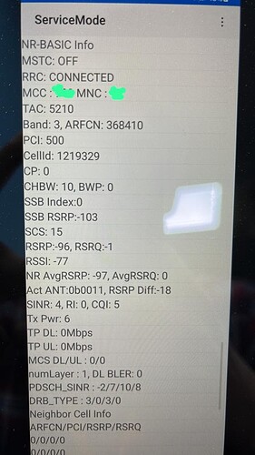

So, I have Samsung S21 Exynos and like 4 months I’m trying to attach it to SA cell, no progress.
How do I validate if it is UE issue, if Samsung doesn’t enable SA support?
