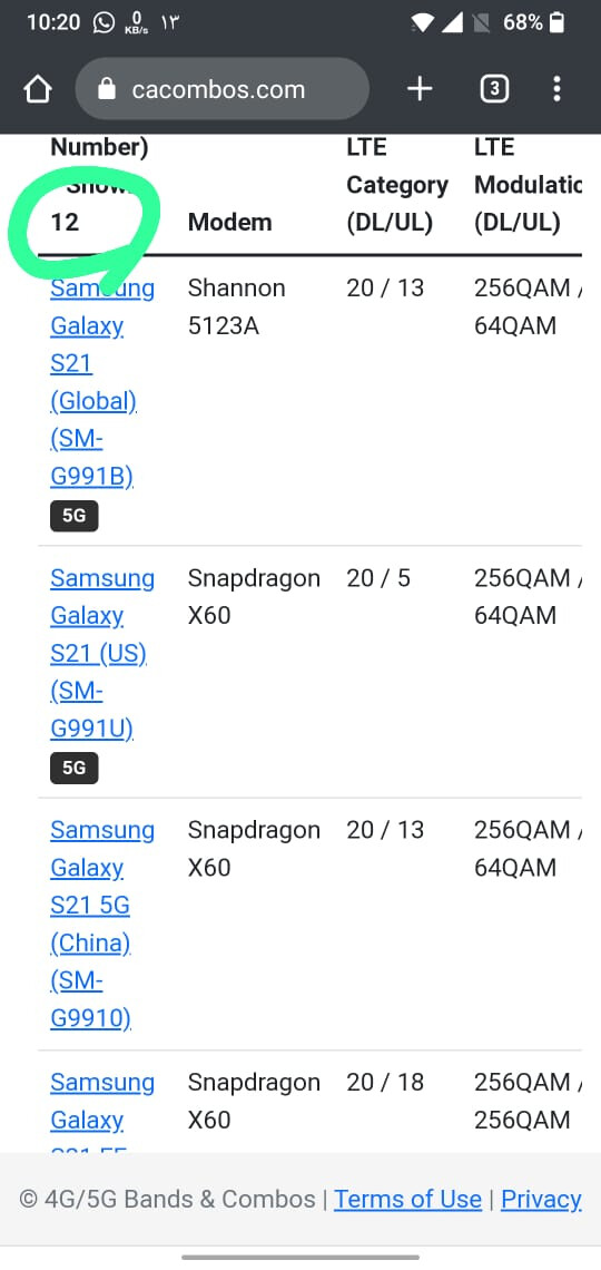

Samsung Galaxy S21 (Global) (SM-G991B) | 4G/5G Bands & Combos only NSA is mentioned.

Maybe the model used in cacombos log collection do not have 5G SA capabilities…
There are 12 different S21 versions.
Are you referring to G991B?
Yes, precisely G991B.
That is exactly the situation with G991B.
Then it should be capable.
