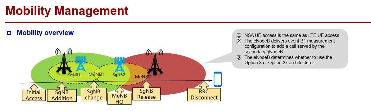

For example, we want to do mobility from (LTE1, NR1) to (LTE2, NR-2) cell.
So, far I believe, handover is possible with MN-to-MN without change of SN or SN-to-SN without change of MN.
This is how it works:
First: LTE1 → LTE2 HO + release NR1.
Then, add NR2.

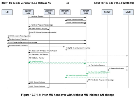

Thanks for the kind response. Following image depicts that 3GPP support MN to MN HO with different SN. (3gpp TS 37.349)
