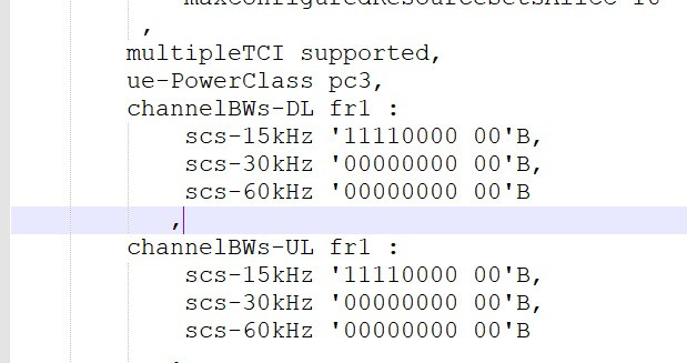

Thank You, got as below:
How to interpret the BW from here?
For FR1, the bits starting from the leading / leftmost bit indicate 5, 10, 15, 20, 25, 30, 40, 50, 60 and 80 MHz.
For FR2, the bits starting from the leading / leftmost bit indicate 50, 100 and 200 MHz.
The third / rightmost bit (for 200 M) shall be set to 1.
scs-15kHz '11110000 00’B ?
It means it supports 5,10,15 and 20 MHz BWP.
