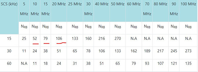

IF BW is <= 20Mhz (5,10,15,20 MHz) does slot level scheduling really brings benefit in 5G in terms of DL throughput?
How much % is higher throughput in NR if we compare it with same BW & same MIMO layers in SA mode ?
@arnab_ece05, can you explain more on this please?
I believe with same configuration & BW <= 20 MHz there is no benefit in 5G SA in terms of throughput compared to LTE.
Do you think any operator will go for TRS and MIMO and beam forming for 5 MHz?

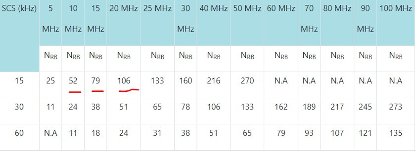

We have some more RBs in 15 kHz SCS for 10,15 & 20 MHz CHBW as compared to LTE.
In LTE, these RBs were wasted in Guard band in band edges.
So in NR, the spectrum is better utilized.
I have generalize the Q not only for 5 MHz.
I am talking about <= 20 MHz & for 20 MHz, yes they should go with MIMO & TRS.
this is Understood, thanks @arnab_ece05.
