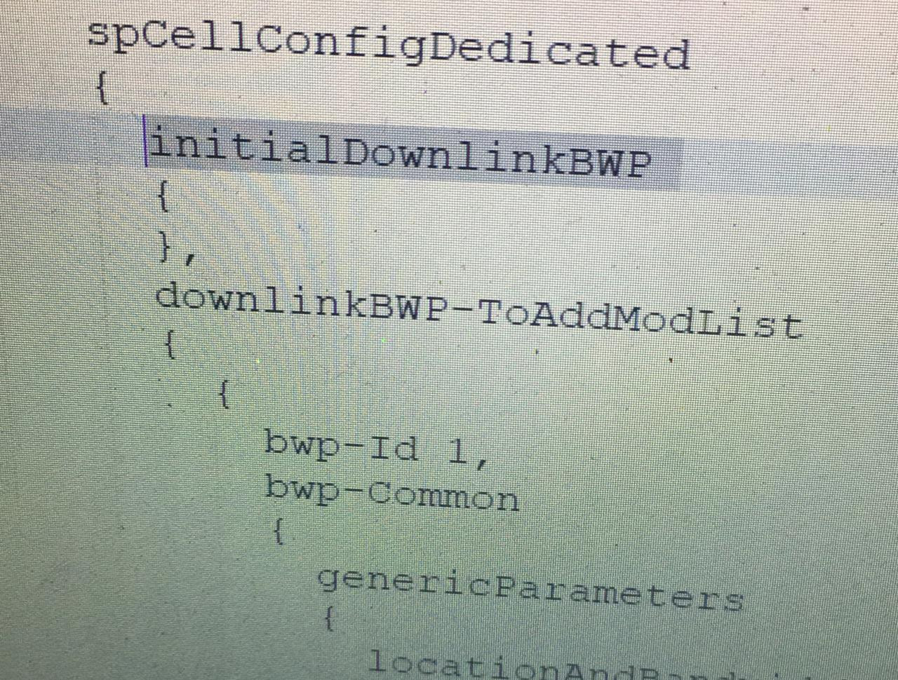

There is one reconfigurationWithSync and in it there is “spcellconfigcommon” in this there is “locationandBandwidth” and UE uses this to calculate DL/UL center freq for initialBWP.
Also there is spCellConfigDedicated and in it there is also BWPID and DL-common and this DL-common also has locationandBandwidth, so the question arises which locationandBandwidth value UE will consider to calculate center freq for DL/UL?
Because the values in SpCellConfigCommon and DL-common are different.

From ENDC point of view, initialBWP is not activated. So the value of DL and UL freq of initialBWP is not meaningful value and can be ignored.
