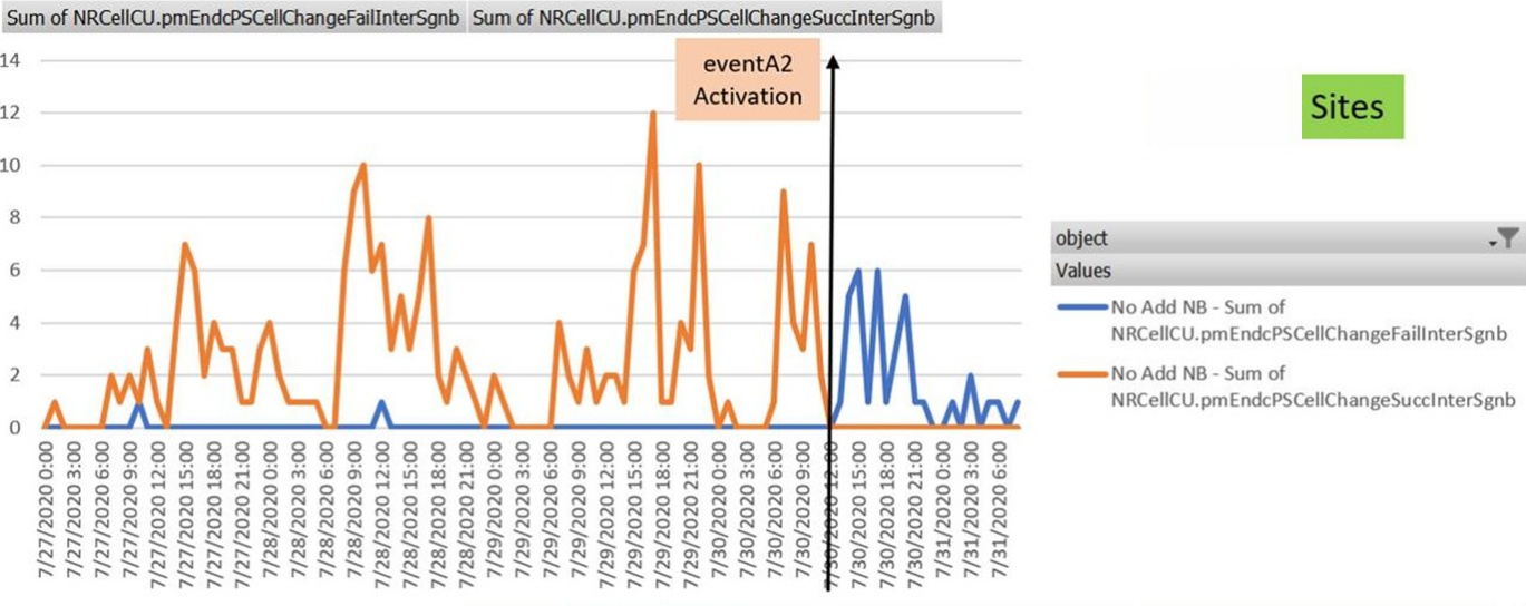

We have recently activated A2 NR release functionality in our network, after that we observed sudden degradation in pmEndcPSCellChangeSuccInterSgnb was reduce to 90%.

Only for those sites where we activated A2 Event on NR.

I believe scenario of failure is this one: UE sends measurement report A3 event in uplink. Then the SCG cell change procedure is ongoing. During this ongoing procedure the A2 events is reported by UE so gNodeB rushes to release the scg bearer and ends A3 procedure abnormally. What it is interesting here is why does it happen only intergNodeB and not also during intragNodeB?
