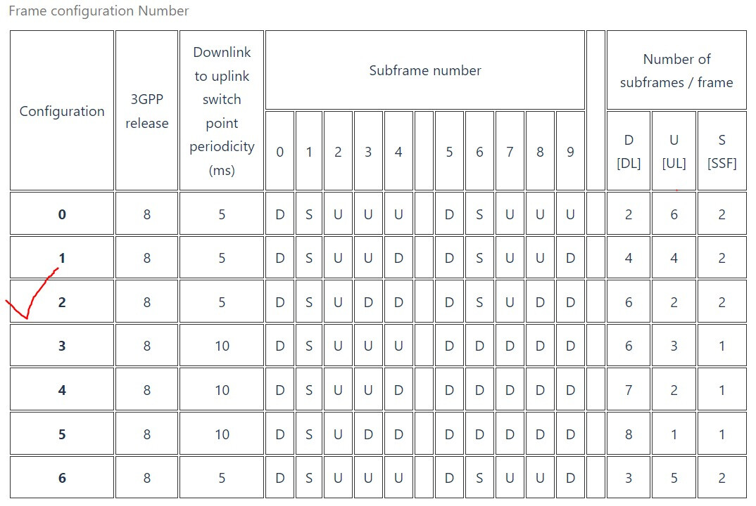

Please tell me what is your network TDD Frame configuration & Special Subframe Configuration.
How many TDD carrier in your network?
Have you roll out is it external or Internal interference?
Config3.
SSF7 and incase of internal interference ssf5.
Plus various other interference mitigation scheme.
