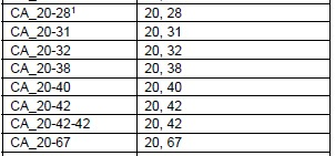

Ok but if you look b20 combination table 5.5A-2 in 36.101 you will not find any combination of b20 with b7 I mean like CA_B20-B7.
Because it’s already covered in B7-B20.
This I find for interband 2 CA:
B7-B20 means anyone can be pcell any one can be scell.
Please tell where it mentioned any specs reference.
No where it is mentioned.
It’s well understood.
You will not find any opposite combination in 3GPP.
It doesn’t mean it is not supported.
If A-B is given in 3gpp, ou will never find B-A.
