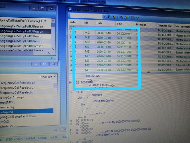

Call setup failure due to RRC rejection on good radio condition
Hi experts,
Can you help please with reason of RRC rejection.
Even on good radio condition many call setup failure due to RRC rejection.
Vendor is Huawei.
What is the reason of the rejection?
I want to know what could be.
Coverage and quality Is good.

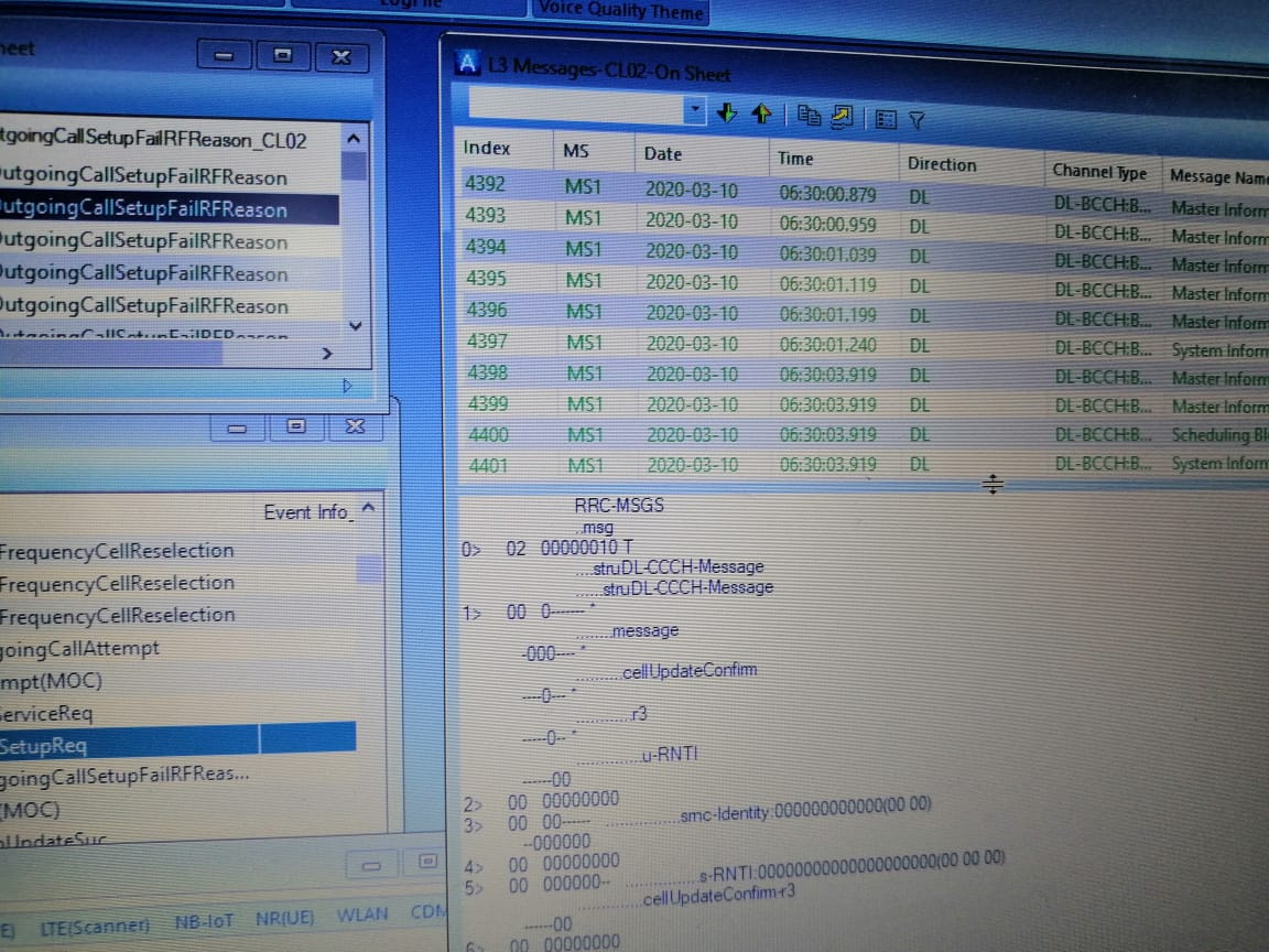

What is the reason for RRC drop? For me bit difficult to see.
What does 00000010 message means?
I am confuse weather it is IMSI issue.

As I check rrc rejection in kpi are not shown but in DT out Call setup failure of some cell . In above Pic I am confuse may be it is Imsi issue?

If you dont have fail in counters, check a trace of your mobil, in this file you can check reason
