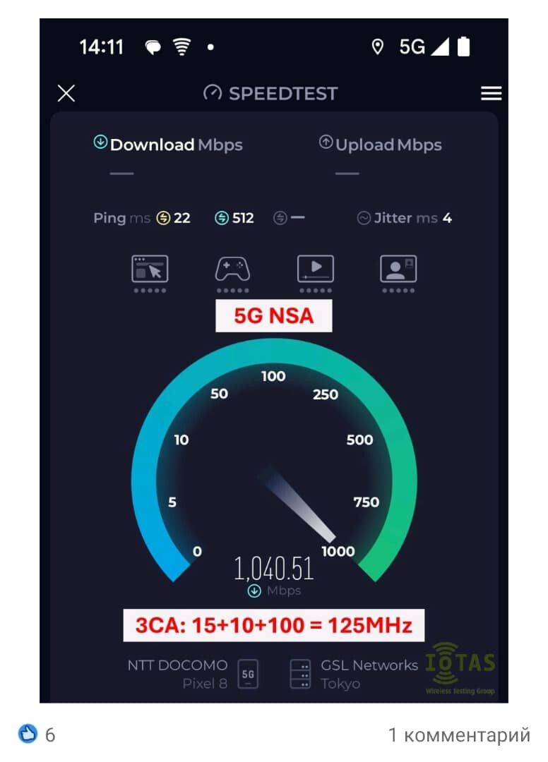

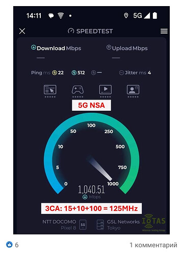

Breaking the Gigabit Barrier on Commercial 5G NSA - Tri-Carrier Aggregation in the Real World
This is not a controlled lab benchmark.
These results were recorded on a commercial Docomo network in central Tokyo using a Pixel 8 under live network conditions.
  • Download Speed: 1,040 Mbps
  • Upload Speed: 102 Mbps (LTE uplink, not shown in screenshot)
  • Connection Mode: 5G NSA
  • Device: Pixel 8
Carrier Aggregation Configuration
  • n78: 100 MHz (NR)
  • B1: 15 MHz (LTE)
  • B19: 10 MHz (LTE)
Total Aggregated Spectrum: 125 MHz
CA Combination: DC1A_19A_n78A
Operating under 3GPP Rel-15 conditions with 4x4 MIMO and ZSN enabled, throughput approached expected theoretical efficiency for this spectrum configuration.
Because this is an NSA deployment, uplink traffic remains LTE-only, which is why upload performance is typically lower or hidden in many speed test captures.
This is not “peak lab performance” - it represents realistic, field-measured effective throughput on a live urban network.

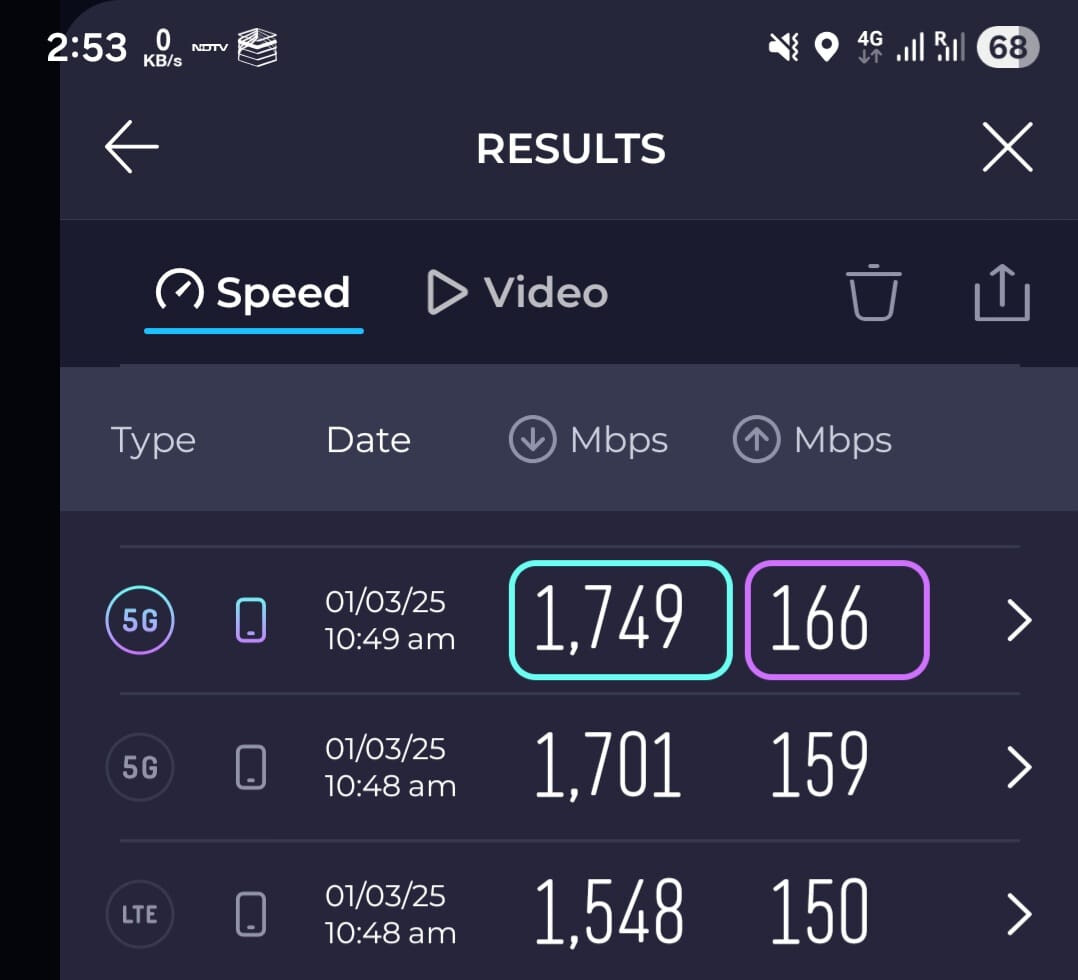

A year ago, 5G NSA carrier aggregation on a live commercial network was already capable of reaching speeds up to 1.7 Gbps.

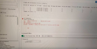

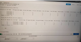

You can see the live UE count per NR cell from the OSS.
DSP NRCELLUENUMBER
(real-time number of active User Equipment (UE) in a 5G cell)

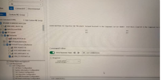

What’s the MML command on the 5G network?
LST CAMGTCFG
On the 4G network it’s set to 2CC.
I don’t know if it’s on the 5G network.

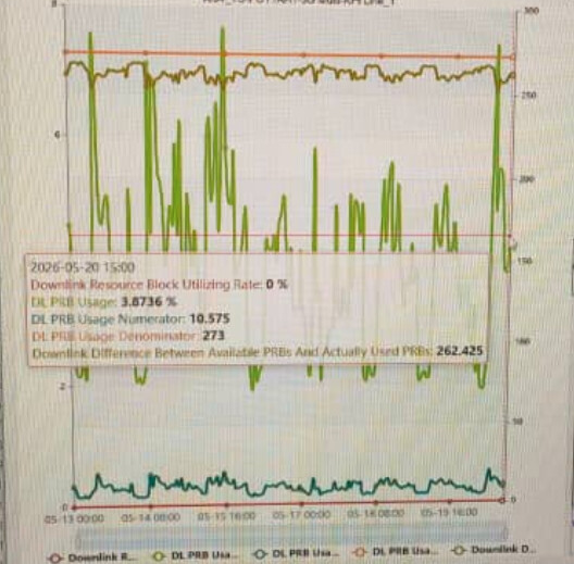

What’s the utilization?
