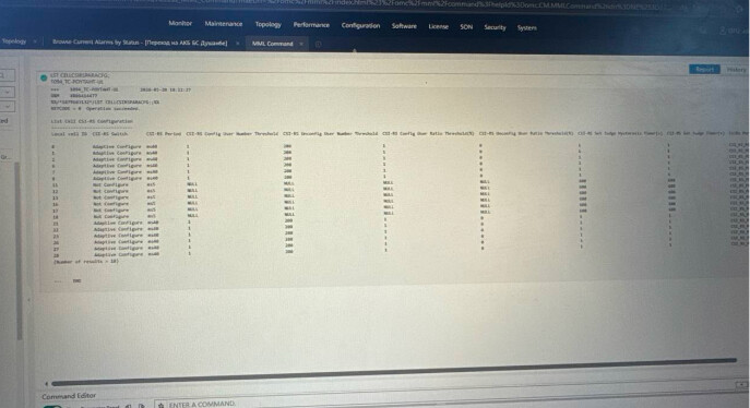

Here:
Sorry, I haven’t worked with Huawei equipment in a long time and I don’t have the documentation right now. Maybe someone else here can help.
Also, from your screenshot it’s not possible to see the number of CSI-RS ports configured for the n78 TDD cell.
Both Ericsson and Huawei have AAU that support 32 csi-rs ports.
I don’t know the exact command to check the CSI-RS ports.
I don’t have the Huawei HedEx documentation with me right now.

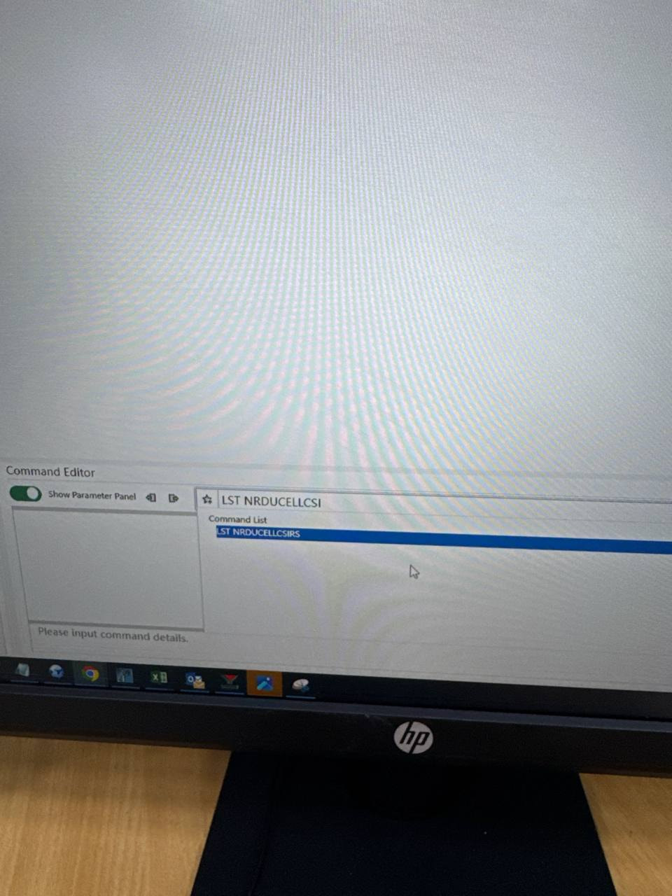

Check these commands:
  • LST NRLOCELLCSIRS
  • LST NRDUCELLCSIRS
  • LST NRDUCELLRSVDPARAM
