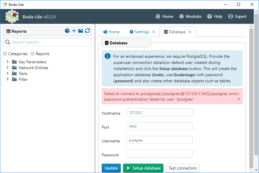

The first thing after installing Boda Lite is to check if it has Database Connectivity.
To do this, click “Test Connection” button, under Database tab.
If you receive an error message, then installation is not ok.
Failed to connect to postgresql://postgres:@127.0.0.1:5432/postgres. error: password authentication failed for user “postgres”

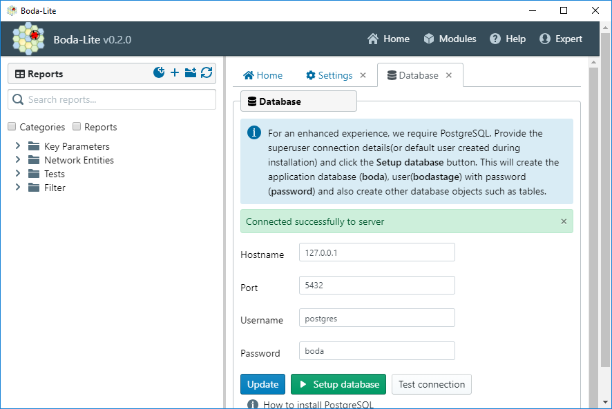

Try to change the password (for the one you provided when installed it).If everything is fine, you’ll receive a success message:
Connected successfully to server

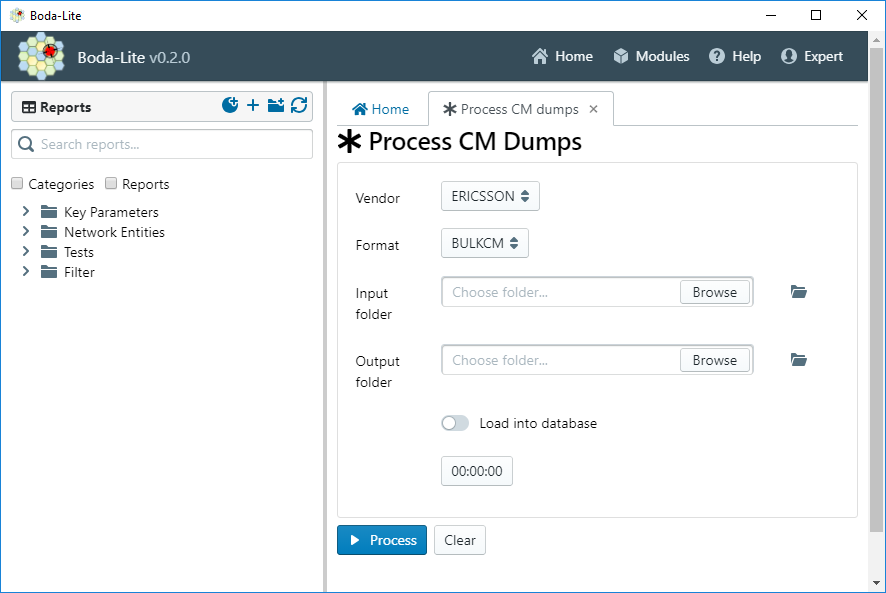

Process CM Dumps
In the Main UI you can click “Process CM Dumps”.
There you will find a lot
