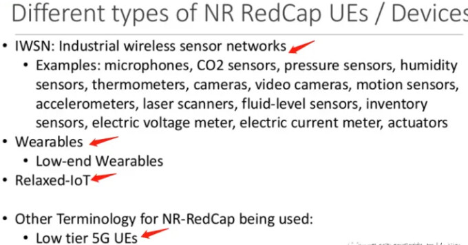

Bandwidth reduced UEs are mostly referred to low-cost, low complexity IoT & CAT-M devices.
Yes, also know as RedCap UE → What is RedCap UE?
Bandwidth reduced UEs means is REDCAP(Reduce Capability) NR Light. REDCAP UE only need 20 MHZ bandwidth FR1 and 100MHZ bandwidth for FR2.
Read More related to REDCAP 5G NR light Redcap (Reduced Capability) feature in Depth
