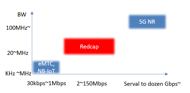

Hi @Silf , @Hainm, it stands for Rel-17 Redcap (or Reduced capability)

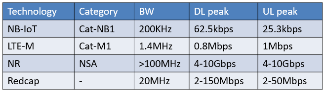

We have today have clearly defined devices for IoT (NB-IoT, LTE-M) (for example applications that require less than 2 Mbps and Small Bandwidth). And we also have devices that are clearly suitable for 5G (NR) applications - High Data Rates and Large Bandwidth.
But what about those applications that do not apply to any of these cases?
That’s where RedCap enters. Formerly known as NR-Lite / NR-Light, RedCap UE fit those needs (range).

  • Target data rate 2~150Mbps to accommodate above use cases

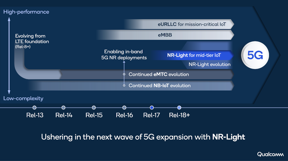

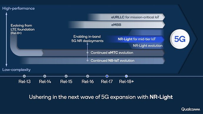

Nice article on 5G NR-Light (Red Cap)
(Qualcomm)
