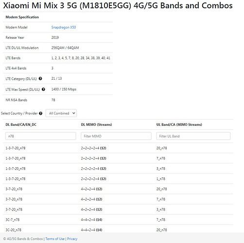

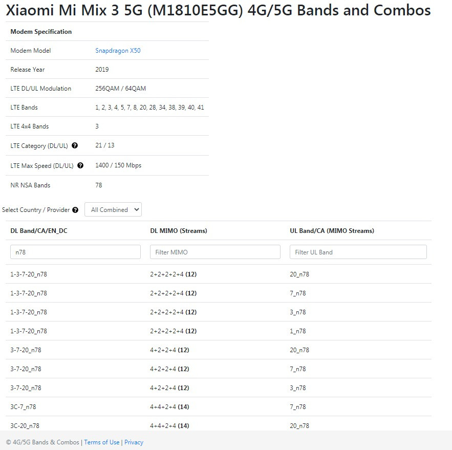

Will give you an example: my 5G phone, Xiaomi mix 3.
Only n78 and only NSA.
Very few band combinations with en-dc.

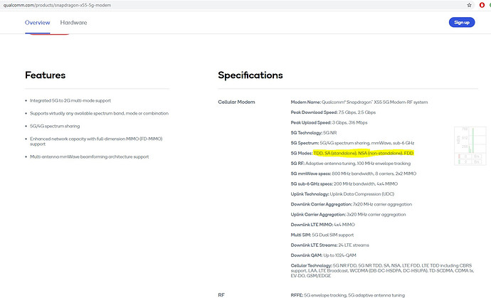

Here are the specs for new coming x65 modem:

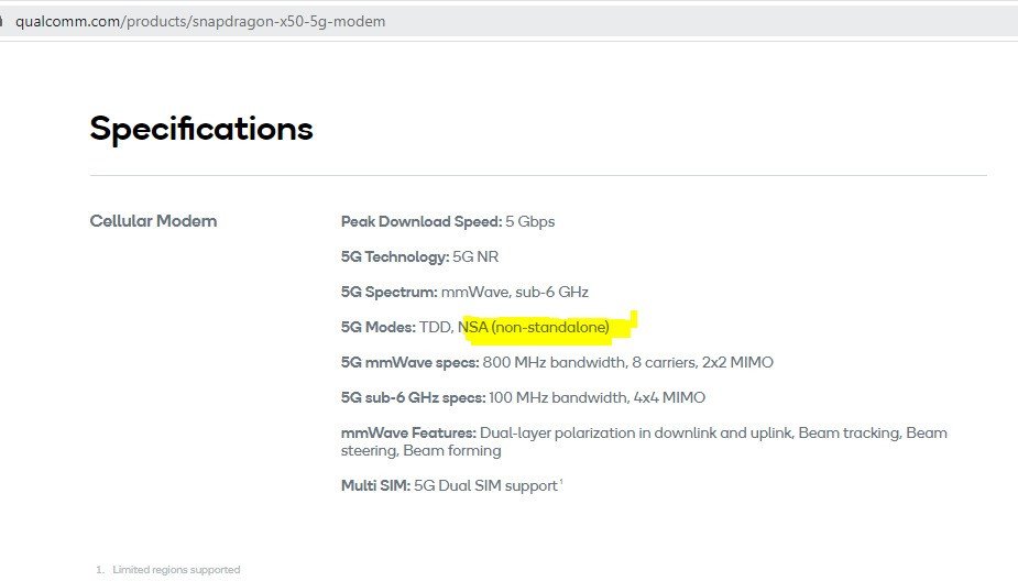

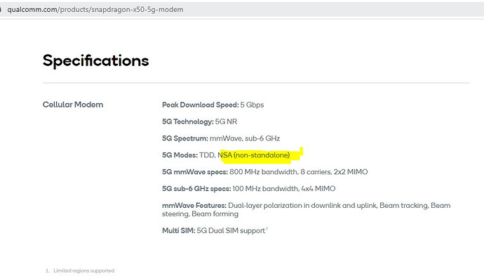

And here you can see that x50 does not support SA:

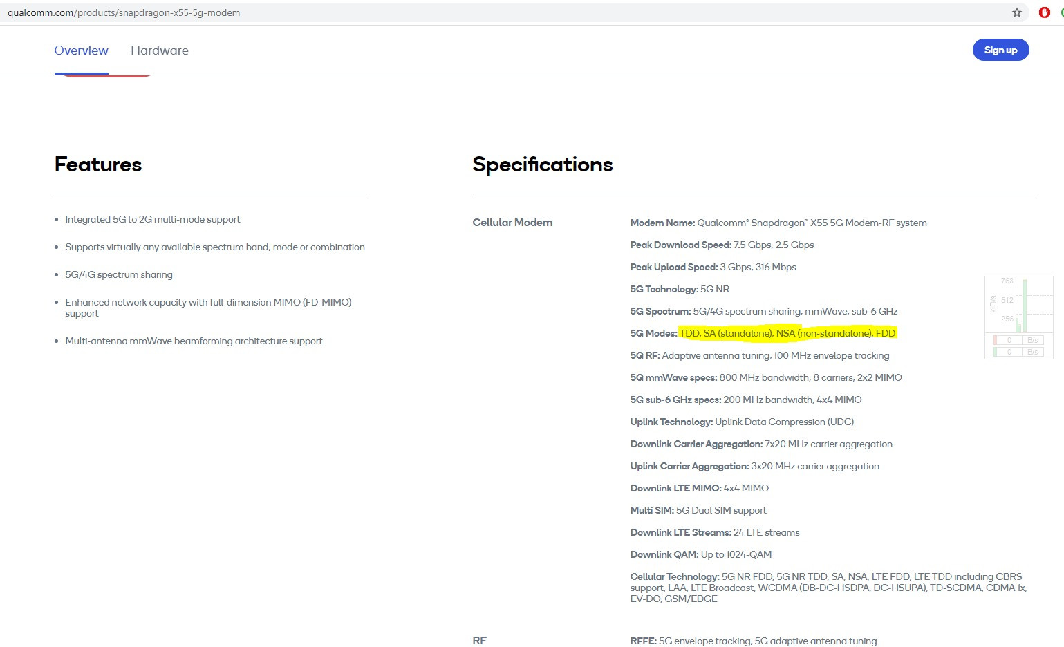

x55 first one to support SA:

All smartphones with x50 do not support SA.

I already given spec reference as well new gen device now have SA and NSA both.

x50 modem does not have NR RRC protocol layer neither SDAP protocol layer.
Now no limitation, but back then at that time there was a limittation.
So this is why we have ues that do not support SA.
All UEs with X50 modem.

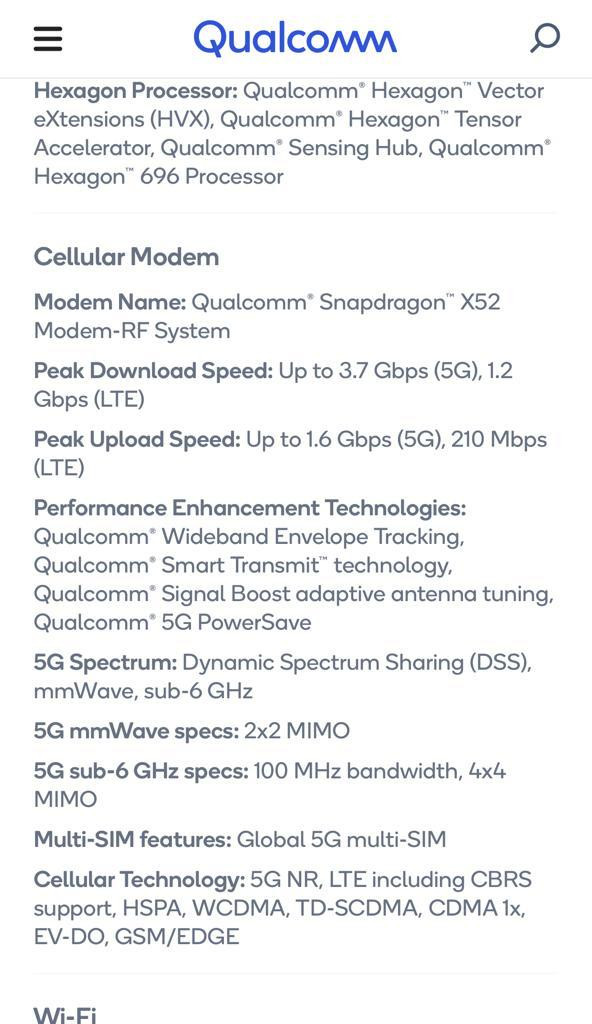

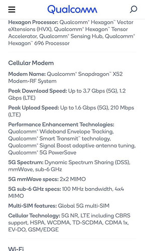

X52 may be mid spec b/n x50 and x55 modem
X55 chipsets support SA for sure and X50 dont support SA for sure
X52 supports SA and NSA
Courtesy: xda forum :wink:
Mentioned 765 also:
