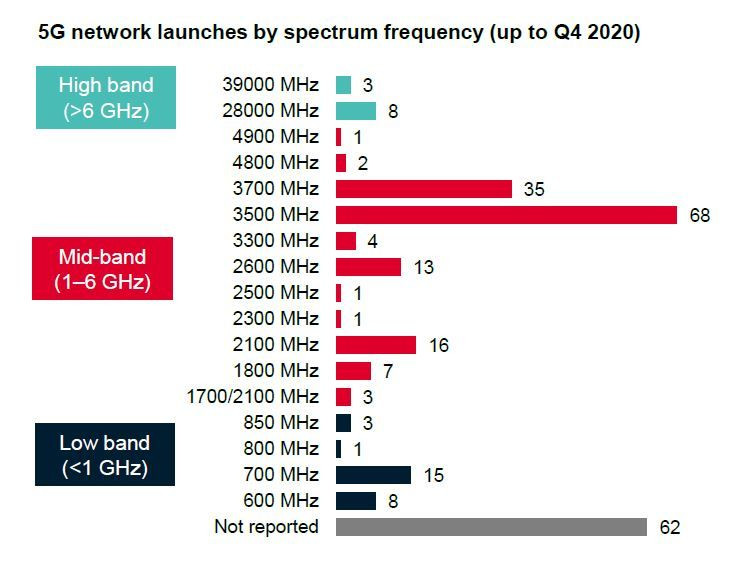

n78 is still the best trade-off between coverage and capacity in 5G.
Source: GSMA on LinkedIn: LIVE with GSMA Intelligence: 5G Spectrum - How Much Will It Cost You? | 94 comments
UE supporting mmW just ~ 20%.
If operators invest in mmW, they can not earn much money…

mmWave adoption is probably slow because band hasn’t been auctioned in all regions, in my view.
mmWave equipment FR2 is more expensive than 5G equipment in FR1 and provides less coverage.

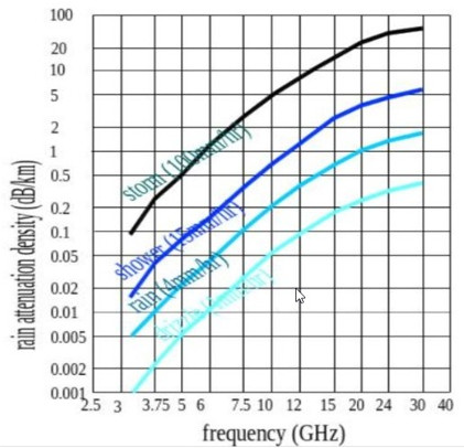

Not to mention when it is raining you can kiss good bye the 5G coverage in mmWave.
Have a look at this picture:
And it’s not just rain, it’s also snow, foliage, vegetation, etc.
There’s a huge link budget issue for FR2 compared to FR1.
