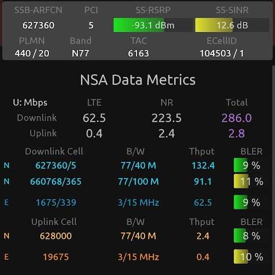

Y mobile uses ENDC normally, and CA on the NR side
If you connect with a terminal with a configuration that does 3CC on the LTE + NR side, you might get 3 on the NR side as well.
Question originally posted here:
https://twitter.com/Qpsk1234/status/1690050637231534081?s=20
First this is not 3CC [NR Leg] has Primary SSB ARFCN: n77
+ SCC :660768
So this is 2CC On NR Leg

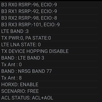

+ LTE Leg : B3: EARFCN 1675
If I am predicting well this B3 + N77 Combination.
And answer to this question is this is implementation based on NR Leg there will be 2CC carriers.
This can be anyways OEM will decide.
