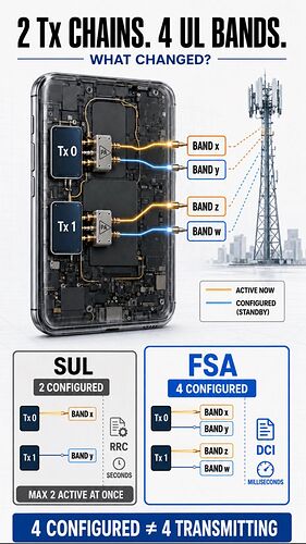

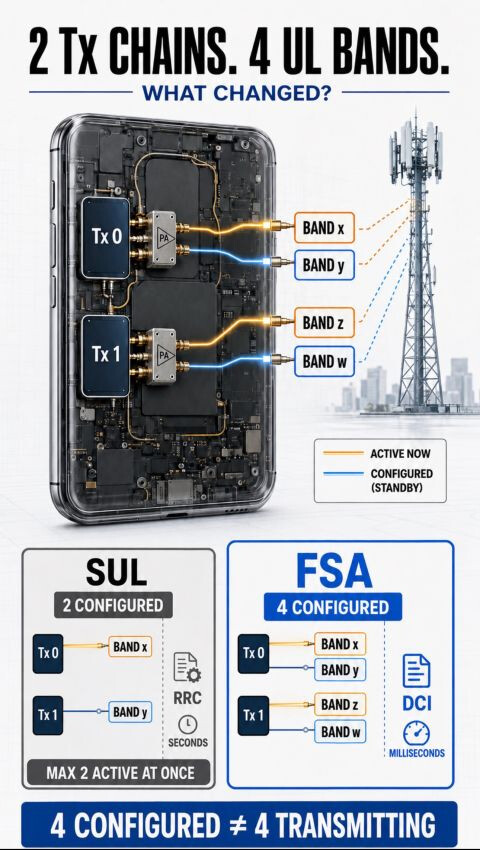

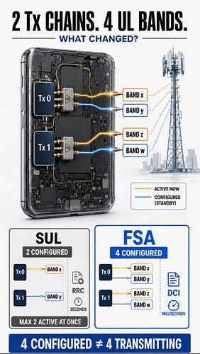

Your UE still has only 2 Tx chains. So where do the other 2 uplink carriers come from? 🤔
So how can 5.5G give it access to 4 uplink bands?
Wait… this is where FSA gets interesting :backhand_index_pointing_down:
With the basic SUL model:
• 2 UL bands configured
• band changes rely on RRC → seconds
With FSA:
• up to 4 UL bands configured
• only 1 or 2 transmit at any instant
• the gNB selects the best carrier or pair via DCI → milliseconds
Based on what?
Real traffic capacity per band, TDD slot configuration and channel conditions.
So no, the UE didn’t suddenly gain 2 extra Tx chains :sweat_smile:
The network simply gets more UL choices and can switch at TTI level to use the best opportunity. Fast.
Same 2 Tx.
4 configured bands.
Max 2 active.
Much smarter uplink.
That’s one of the mechanisms helping 5G-Advanced move towards 1 Gbit/s UL.
The trap?
4 configured ≠ 4 transmitting.
Many people miss this detail.
