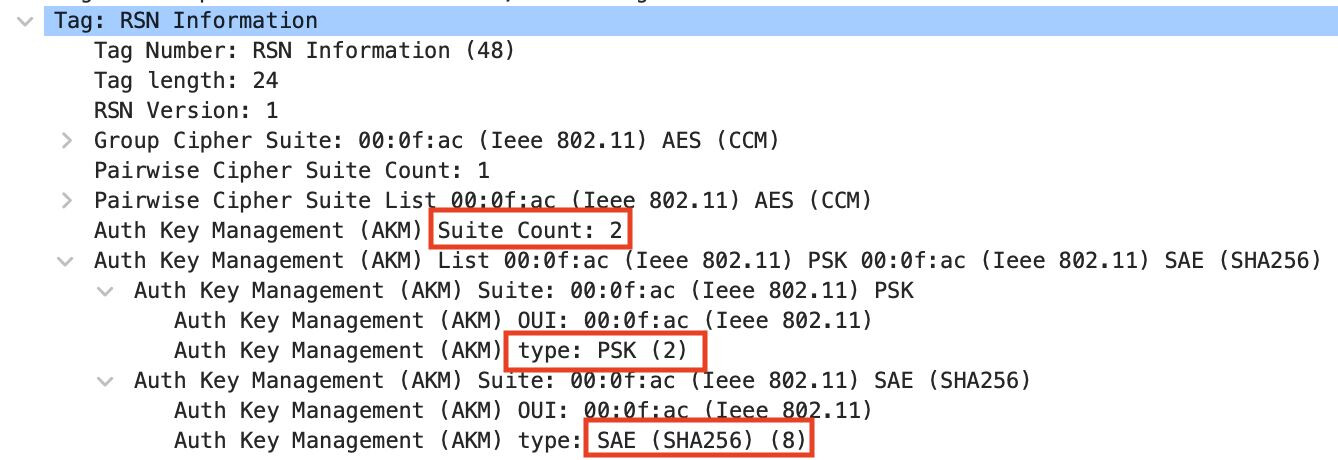

This is how WPA3-TM looks like on a beacon frame.
If you look for the RSN Information in the tagged parameters, you can see that 2 AKMs are being used: one PSK (2) and one SAE (8), which are WPA2 and WPA3 respectively.
It is expected that devices supporting WPA3 will select the AKM = 8, while older devices will select AKM = 2.
However, this does not seem to be always true, and some of them will simply refuse to connect to the SSID.
I am still testing my device to check if they will behave properly connecting to this SSID.
Newer ones could connect with no problem, selecting WPA3, as expected.
