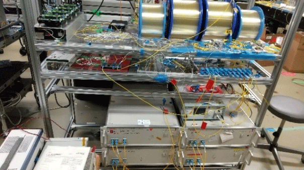

One of the exciting aspects of the new data transmission speed record is that researchers achieved it using an optical fiber network not dissimilar to those currently used for internet infrastructure. This, the researchers say, should make future upgrades towards this sort of speed easier.

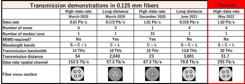

The experiment used 0.125 mm diameter multi-core fiber (MCF), with wavelength division multiplexing (WDM) acting as the magic ingredient: This technology means signals of different wavelengths are sent simultaneously through the line. A total of 801 parallel wavelength channels were packed into the same line.
Another innovation was to use four cores instead of the standard one, essentially quadrupling the routes for data to take, all while keeping the cable the same size as a standard optical fiber line. Researchers also applied various other optimization, signal boosting, and decoding technologies.

  • 1 petabit per second transmission capacity demonstrated in a standard cladding diameter fiber using only 4 spatial channels
  • Wide-band wavelength division multiplexing technology enabled 801 parallel wavelength channels over a record 20 THz optical bandwidth
  • The demonstration is a major step toward the realization of ultra-high-throughput optical links with standard cladding diameter fibers compatible with existing cabling technologies for near-term adoption
